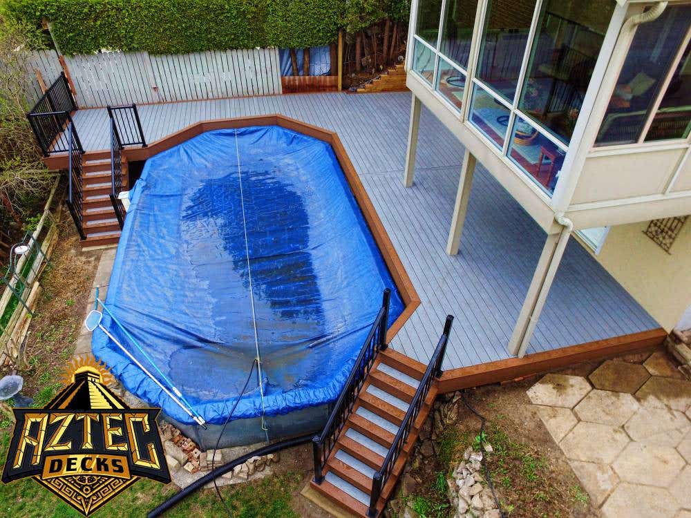

Composite pool deck
5.5K views 20 replies 6 participants last post by  CityDecks
Timbertech Edge composite decking, Classic (regal) aluminum railings.
Almost 700 sq ft of back-breaking fun.
