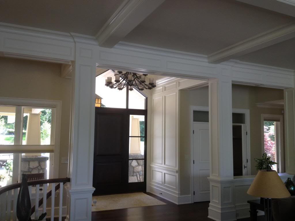

Hi guys,
I'm looking at wrapping some interior square columns, currently finished with drywall, texture, and paint. Just curious what types of wood people have used. Has anyone ever used Southern Yellow Pine? Clear fir would be great, but don't think H.O. will want to pay that much. Any thoughts?:blink:

I've done a few with Poplar. You can go plain Jane or deck them out.
I've also used poplar.
Adding a subtle taper to the columns can be a nice touch as well.
Poplar works well for paint grade, alder can be inexpensive for stain grade.

I've used FJP plenty of times. Inexpensive and stable. Obviously only works for paint grade.
A job I did 2 months ago were I wrapped columns in 1/2" MDF. All edges ripped on the 45 then glued and nailed with 1" brads.
These are basically just mdf with panel mould and some fjp trim. Pretty overpowering design for most homes but anyway.
Reactions: 3
Poplar for paint grade. For generic stain grade, alder, though it's nicer to pick a wood the character of which you can highlight.

Wow, thanks for all the quick responses. This will need to be stain grade. Looks like poplar or alder would be good, although I might look at that MDF or hardwood ply idea. Thanks for the photos, looks great. Don't think there will be room for storage at the base because the columns are at the entrance to a room. Thanks again. Not doing the work for a week or two, so will take some pics and post them.:thumbup:

I have used different types of wood, but for something different on a basement remodel I did I took a sonotube and cut it in half. I put it around the column and used a stud to screw the tube back together. I then wrapped the tube in self furring metal lath and covered with dryvit. You could use plaster but this was a sidejob (union carpenter), and I got the dryvit off of a job, as the plasterers had extra and were throwing it away. It turned out awesome and the HO loved it. I wish I had pics
