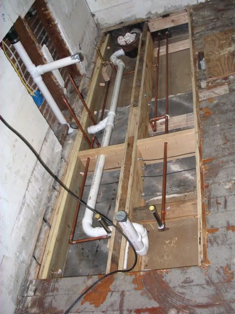

Ok guys. I purchased a house im going to remodel and noticed that someone at some point cut a whole 2x8 joist for the bath waste :eek:. Whats the plan of action for this in most states as im sure some of you plumbers have come across this in the US. Also i noticed that half the house had pipes running in the center of joists but only half inch cooper and the other half had the copper running below the joists. hows it ment to be or are both ways fine. In UK it's fine running pipes through joists as long as they stick within the code limits.

Any chance you could get a picture? Anything is better than what you have. I would be concerned about this joist sitting directly under a tub. Are the joists at least going accross the tub (more support)? Depending on what exactly it looks like and how hacked up it is, here is what I would do. Sister on another 2x10. If you can get one side to bear on a wall that would be best. Then use some 16D framing nails, about 5 every 16". Then add four 1/2" through bolts on each side of the break. That will be very solid. But again I would be careful with the tub being directly above.

They are running the direction of the tub so less support but your idea would prob work. I will get a pic next time im there.

Was that PVC tested for leaks, i see duct tape on the risers. I would test that PVC for leaks, before i close that Floor up.:thumbsup:
Good thought, 9 months ago. :thumbsup:
Tape was after to keep flooring
debris out after caps were cut off.
No leaks.

heres that pic of that joist. What im amazed at it it aint dropped at all over the years. even though it's the main joist under the tub!
Cutting the joist completely in half like that could have been avoided, and if one my empolyees ever did something like that, they would be fired. Part of the problem is that Slip Joint "POS" tub waste on that tub. You could have used what the call a "watco 600" and hard piped the drain. Notched the top of the joist for the shoe of the tub drain, and shot over to one side or the other of that joist, and offset your riser from the brass trap. :thumbsup: That joist is nothing but deadwood now. Might as well rip the whole damn thing out.

This is simular to a watco, and would work just as well. Again, any think with slip joints, or trip levers is junk in my opinion. Nothing but problems down the road.
We just installed a kohler Trip lever waste, with the external lift rod. This particular one, you twist the overlow plate back and forth to raise and lower the plug. It is very hard to turn. Its all garbage that will eventually fail. Lift and turn drain like pictured above is the best of the best, and most used. the assembly is a hard piped with 1-1/2 sch 40 pvc. Doing it that way, makes it easy to offset.

Yeah that's what we do. Offset and use the prefab brackets I pictured above in another post. Use of metal bracket is more of a quality issue than a necessity most of the time.
Notching for the shoe usually doesn't require more than removing 2 - 2 1/2" of material.
