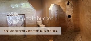

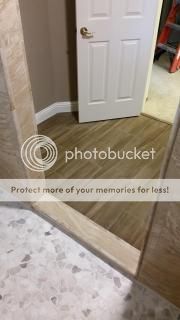

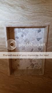

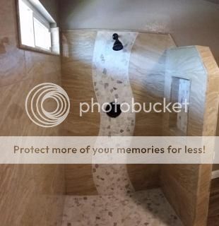

Backsplash is Tumbled Adelia.
The shower is a total of 250 square feet. 10' high! 18's on ceiling and floor. 12x24 on walls. 26" long niche. 41" seat
Quickdrain system and Innovis Better Bench. I kinda like the Better Bench
