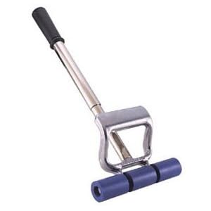

Here are a few excerpts I found:
"As you press the DITRA it will displace the thinset for a moment under the pressure but then try to return to its memorized shape and could create voids under the DITRA."
"Last year I was putting down a lot of ditra and got tired of crawling around on the floor pushing it in by hand. So I bought a 100lb. roller just for that purpose. Then....
I went to the Schluter class about a month later and they specifically advised against using a heavy roller on Ditra. They said the only roller they would recommend would be a 35 pounder."
I'd say call and get Herr's blessing before using one.
