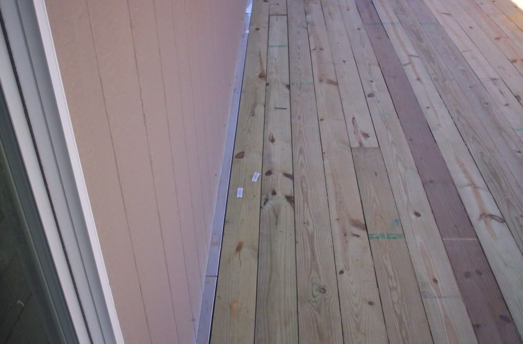

Anyone know of a proper way to flash cantilevered deck joists? Water gets in and collects on the window sill inside. I think it's getting in under the L flashing. Here is what I see underneath.
I thought I would remove the first two decking boards, and rip out the L flashing. Then replace with Z flashing and cut a 1/4" kerf cut in each joist for the Z flashing to fit into, then put caulking every where.

HI Kenn, it looks like a pretty bad scenario to begin with. Either the joists are running back into and penetrating thru the wall and they blocked in between the joists or they toe-nailed the joists to the siding or rim joist.
Either way your suggestion about he kerf looks like the way to go only I might cut it a bit deeper, say 3/8-1/2". I think you would still be in code compliance as you can notch the joists that deep and close to the ends.
I think that way you really don't have use much if any caulking.
Andy.

There's no supporting posts on the other end of the deck. So it is a cantilever, it's just an extension of the floor joists inside the house. Yeah I think my suggestion is the only way to go. I also noticed where water is getting in, there is a cupped joist, causing about an 1/8" gap between the block and the joist. That's basically an open gap for water to run right through. So I think I need a bead of caulk down every block.

I would think a bead of chaulking applied at the yellow mark would stop much of the traveling water but would be more of a band aid.
Perhaps you could cut these joist away and install a better system all together. A new ledger board Rim board to the home with all the proper paper and flashing and a second one over top with 5/8" PT rain screen strips so that it doesn't make contact with the homes board. Then some hangers at this point.

My two cents: I'm not sure about kerfing the joists. It would definitely stop back migration water, but I also think it would inject water into the joist. I think a cut and bend of the flashing with graco underneath would serve better.

the assumption being that water is wicking in from the joist may be wrong,i think you need to pull some siding above and below and check the wrb/flashing situation before you kerf anything
you could probably seal the penetrations using a flex wrap around each joist pretty effectively
is it possible to get rid of the blocking?

Pulling some siding installing a flashing as planned is the way, I cant see how caulk under the flashing by the joist would be bad.
As long as your at it why not shim over bevel the 1st deck board and cut a kerf in the underside. Then you can flash ontop as well as below. A little overkill but now you would be creating a drip cap senerio.

If it is I kerf the joist as minimally as possible for the z metal. I also use a z metal that goes past the block line.
I then run the kerf down the joist to the bottom to give the water a path on both sides. These kerfs barely go into the joist its more of a scratch.
I finish the kerfs with a treatment solution. IMPO its important to lead the water straight down the joist from the flashing.

I took some more pictures and tried pouring a bucket of water on the deck to see what would happen. It looks like it's doing what I thought, it goes right under the flashing. I don't see anything to keep it from going past the blocks either.

Now that I see it better I think it calls for some really special flashing.
3" high min. under siding, extend 1" past the outer face of the blocking, create saddles to go over each joist and extend to nearly the bottom of the blocking in the corners where the joists meet the blocking.
