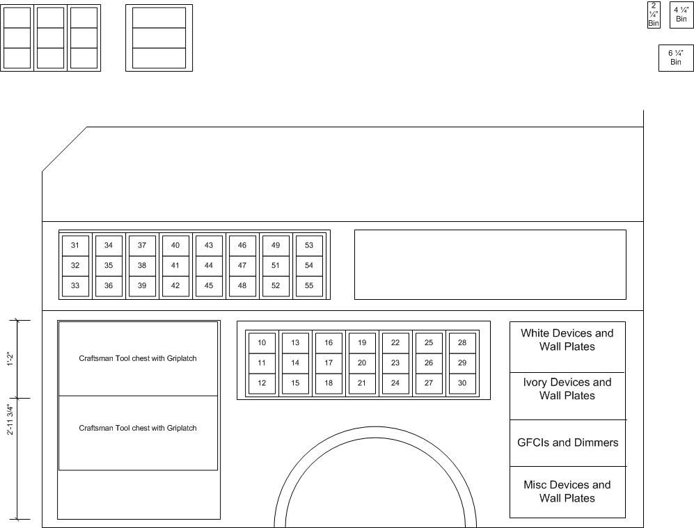

The countdown is on, and I need to start getting some ideas on how I want to organize and outfit the utility body on my new truck. I bring the chassis cab into the builder on 1/12/2010, and pick it up hopefully on the 20th.
I already have some ideas, and a stockpile of parts, but wanted to get some input anyway. Here is what I have so far.
I am using the Adrian Steel DC6 and DC12 drawer units. Layout is not set in stone, so critique as necessary.
Tool chests in front compartment
I think I may move the devices and the tool chests to the curb side. Other than that, it is blank.
For the inside I am working on conduits for storing fish stiks, benders, and other long items. This will be on the curb side interior wall.
Floor plan for interior, and all my push carts will fit in it as well, not very often though.
I also plan on building a shelf in the front for all the bulky tools that don't get used everyday.
And yes, it is crude, but it is to scale for the most part. After all, it was made on Visio, not a high dollar program.

Looks great so far, I can't wait to see the finished truck:thumbup: I have been doing the same thing with my truck for a while trying to find a good layout. Its tough, I've found so far the best way is to start with something and based on how you use the truck change as needed.
With my utility trucks my old wise boss told me put the most used things on that passenger side so if you park on the street you are out of the road. Most of the time there is a driveway but it is a good concept. I like your degree and disire for orginazation its awesome.
That sure is a Snazzy looking Rig !! On my Utility I have pull out drawers that are the full width of the bed up at the front on the passenger side.,. They have dividers in them & are perfect for electrical stuff - switches.receprtacles,connectors, breakers,etc. I keep all my parts on the passenger side & all my tools on the drivers, so as soon as get out the first thing I grab is a tool that I need for the job & then usually come back for the parts on the Passenger side which is away from the road.
Also love my ladder racks which are higher up front & lower in the back for ease of sliding in & out. I used to have a van with racks that were level- what a PITA ! Of course you have to consider looks in everything you do with that thing of beauty.....................

nice rig, I personally would go with a 12 foot chassis box. how long is yours?

Start with racks that post through to the frame or floor, real strong.
Right side lower:
Rear tall box holds pancake compressor, hoses, cords
Center (short) box holds portable table saw, belt sander, pad sander, and lots of clamps.
Front tall box holds all air nailers, staplers, knee pads.
Upper boxes, everything in tool boxes lined up side to side, 8 boxes per side.
Left side lower:
Rear tall box holds drywall tools, caulk, sponges, and hopper gun
center (short) box holds 5 tool boxes with 1/2" drill, hole hawg, drywall screwguns and router, angle grinders, rotary hammer.
Front holds hammers, bars, pencils, chalk boxes, chisels, tapes, laser transit, ram-set, and assorted other stuff.
After using it I wondered how I ever worked without it. It holds a ton of tools and parts.
