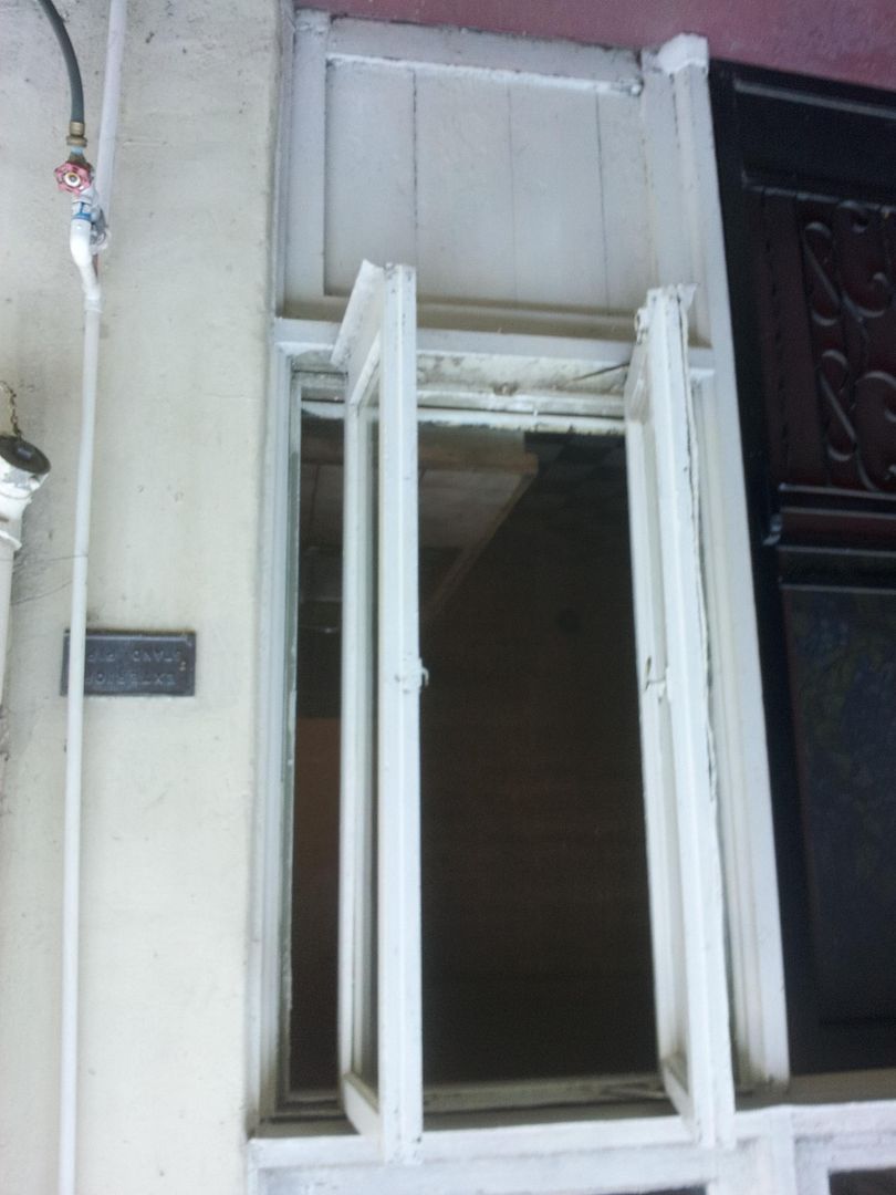

This is a historic (1928) concrete apartment building (Bing or Google 1750 N. Serrano, Los Angeles).
These swing-out windows have built-in roll-down interior screens.
Do you work with historic buildings and windows? How would you deal with these windows? Do you know anyone who is a historic window specialist?

Doesn't the historic district have some kind of criteria to deal with refurbishing windows in contributing buildings?
I have done a lot of work in the historic residential district in Orange and the basic thing they want is if something needs to be removed you exchange like for like.
Meaning you take out wood casement windows you put back in wood casement windows.
Andy.
2,495 Posts
A lot of wood window manufacturers (HURD and WeatherShield to name a couple) have historic restoration lines of windows. I know both have casements that open to a full 90 degrees (unless code requires limit locks on the sashes) and would look VERY much like what you have there now. Except for the hardware and the built in roll down screens. But I wouldn't think that would be a problem.
You could very likely find someone to restore them, but you'll end up spending a lot of $$$ and still have older single pane, inefficient windows.
I would personally look strongly at replacing them if it were me.

Bull. A single glazed window with a well fitting single glazed storm window is on par with most windows available today. A single glazed window will out last any double pane window 5x over with minimal maintenance.
I know a couple window sash guys on that coast.
2,495 Posts
I don't see any storms on them Darcy. And, being casements, I don't think you can put storms on them. While I agree that a re-worked, tight fitting casement would seal well, the single pane glass will still be inefficient as heck.

It's LA for one, storms go on the inside of casements, just like those roll up screens.
I hate the mindset of tossing beautiful old windows because they are not efficient.
New windows would ruin that place.
Well, I learn something every day. Even an old fart :wheelchair: like me.
I didn't know anything about inside storms on old casement windows. I totally agree that restoring the old ones would be the most ideal.
Especially, if they have that old wavy glass. :thumbsup:

From what I see, they'll need to be removed and any framing issues dealt with. They're pretty easy to rebuild - I'd set aside 4 hours per pair for a rebuild (including glazing and paint), unless I have to fabricate intricate wooden parts. Net cost is comparable to a replacement.
Usually, the toughest part is finding the mechanism parts - whoever did maintenance should be able to tell you what fits / looks good. That goes double for the pull down screens.

Not going to get in the argument about whether you should repair or replace, but if it's on the historic register, you will need windows with National Park Service approval.
Those replacements would be almost identical in construction and design to whats there in order to get their approval.
In my experience, restoring correctly will be significantly more expensive that replacing with a historic profile window.

Since I posted this, I've spoken with the architect and learned that the sashes were replaced long ago, and that the window assemblies were set into the concrete walls without proper water sealing. Many of the sills and sashes are rotted and/or eaten by termites.
I will pass along the names of any specialists you-all can recommend to the architect and manager.
Storm windows are rare in southern California. After all, this is an area where it is OK (other than appearance) to run water and sewer piping on the exterior of buildings, as it does not freeze.
