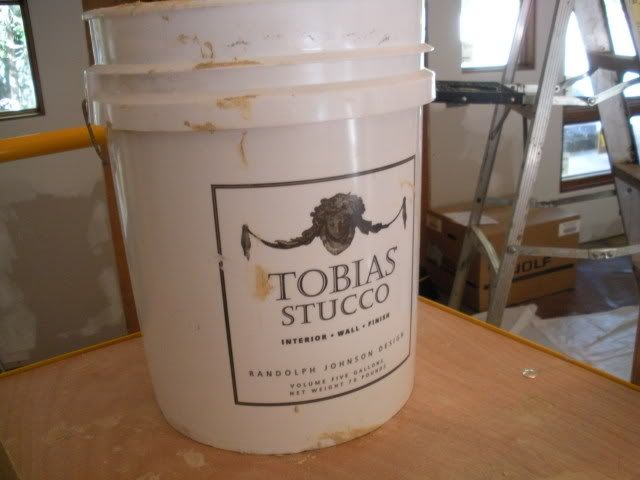

Been applying this product the last few days. Purchased through Green Depot. My application is over new sheetrock, however many different substrates will accept this product with different levels of prep. For new sheetrock primed surface is required, color tinting the primer is an option. This product is very easy to work with, about 20 standard colors available. I applied with a metal trowel, first coat went on with an 8'' knife, because of the barrel cieling the first coat with the 8'' knife could only run in one direction (with the curve). Day two final coat was applied with a 6'' knife in a hatch pattern. After 5 minutes the second coat was knocked down with a 10'' knife, again following the curve. Also, the first coat went on with a tight trowel technique 1/16th" thick. The second coat went on a bit heavier 3/16th max. Here are some photos of the technique i used, the interesting thing about this product is the number of finish options that can be achieved based on different techniques. If you would like more detail or photos, just ask. G

We have used this product on several jobs. I've alway's been pleased with the results. Thanks for the revue, And nice work Gene. :thumbsup:
Here's the link to their site------->Tobias Stucco
