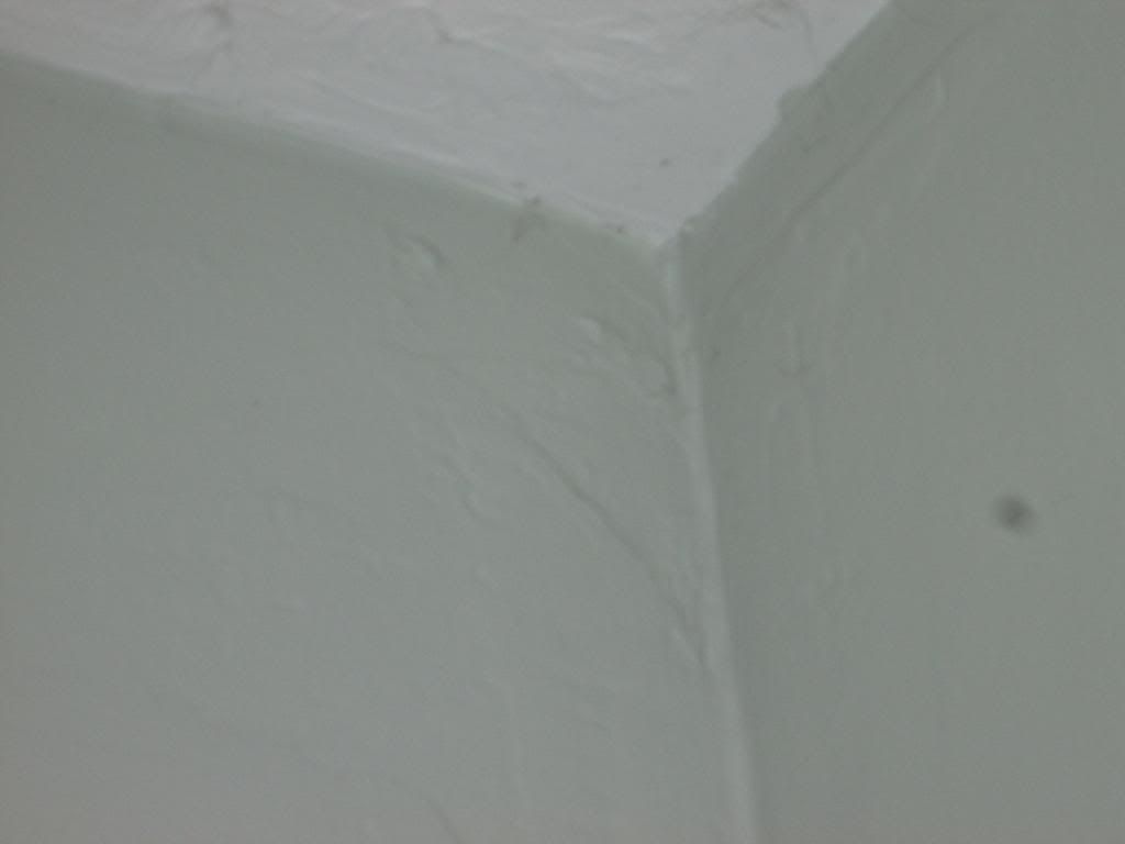

Got a call this evening from a client I hadn't talked to in about 2 years. He asked me if I would go inspect a house for a friend of his that was thinking about moving to the area.
I knew which house they were talking about. Its been on the market for about 3 years. Its listed for $795,000.00 and to be completely honest there are few people in this area that can afford such a house. Its being advertised as "Newly Remodeled" "Fresh Paint" "Lots of custom wood options".
Anyway, I went to do a walk through with my client's friend. My camera battery died on the ground floor. But I think you guys can get the idea.
Realtor was touting it as a "Show Piece" home.
For close to 800 grand this level of finish work in unacceptable.
It listed as 4500 sq/ft, I didn't measure it but looked closer to 3000 sq/ft to me.
Switch box to close to the wall? No problem cut 3/8" off and mud it in.
Only a true professional can finish drywall this smooth.
Who said baseboards were suppose to be tight against the wall?
Good tight miters, this is one of the better joints in the house!
"Custom" woodwork.
Now this is how you hide TV cable. :laughing:
And about 1900 sq/ft of new hardwood laid like this.

Colonial casing and 3 1/2" base shouldn't be outside of non-walk-in closets in an $800K home.
No kidding. I wish I could have gotten some pictures of the upstairs. It got better, the further you went.
Had a cedar lined closet that had been hung with clipped head 8s.
All the casing in the bedrooms was ranch style that had been put up backwards.

Also had some colonial casing being used as base in one of the closets.
The room that had shoe, it was installed backwards. You know, the longer part that is suppose to be against the wall. I guess it covers a bigger crack that way.
They had also pulled all the brick mould off the exterior doors and replaced it with 1x4s. Installed with screws no less. :laughing:

Client's friend said he had learned a lot in the hour and a half he spent with me this evening.
I showed him EVERYTHING, if it was wrong, messed up, or I just didn't like it. I picked it apart for him good.
Realtor was there as well, I thought she was going to have a stroke when I stuck my pocket knife in that miter and took a picture. :laughing::whistling She was sure glad when my batteries died.
