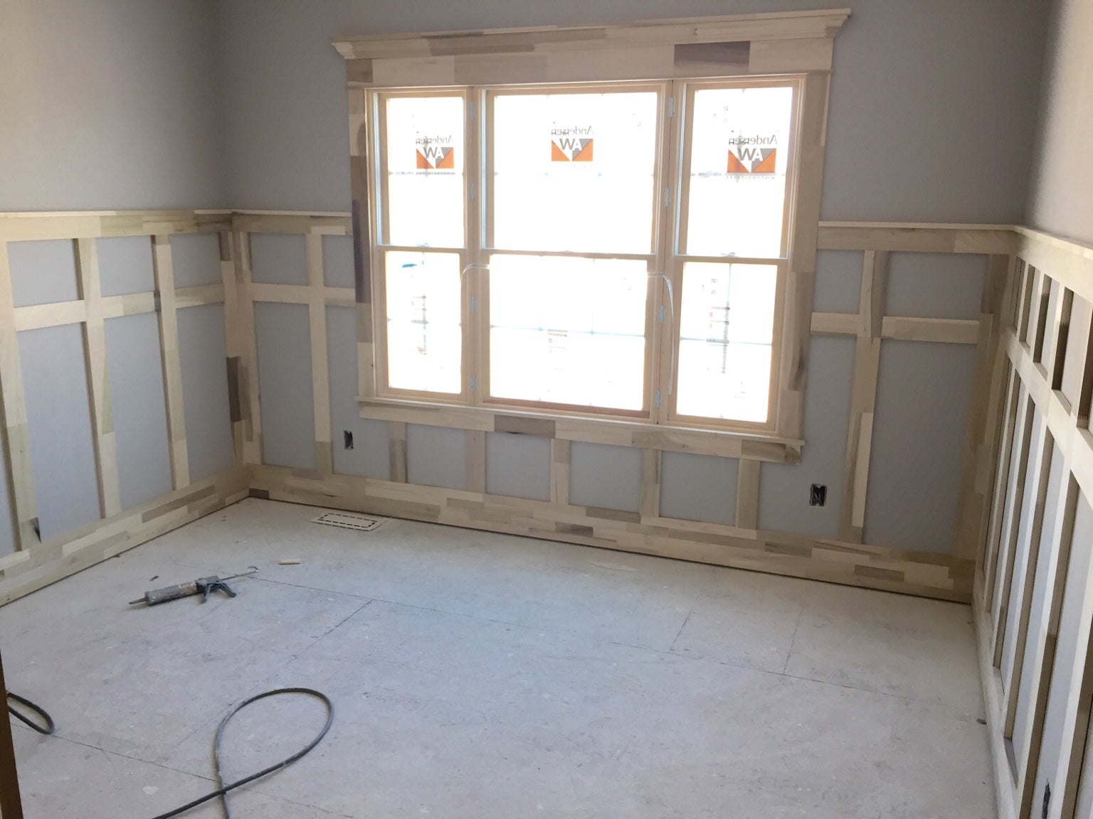

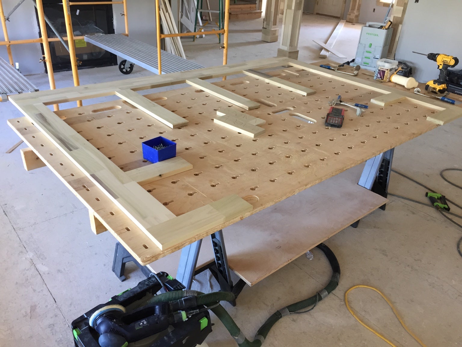

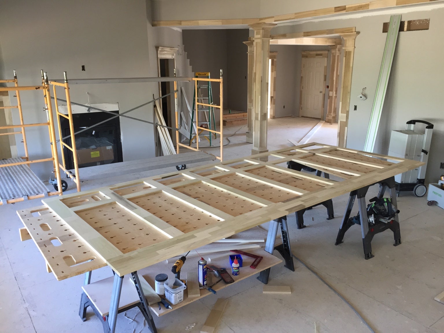

Wainscoting is time consuming. The foreman is a huge advantage but it still seems like there has got to be a way to get the stuff together faster.
Any experience in poplar? Splitting an issue?
The downfall of the gun would be that if you nail it wrong the whole piece is screwed whereas you have a couple minutes that you can still get a kreg/glue joint apart if you realize you flipped something backwards.
They are expensive tools and so is a box of fasteners but I'd really like to give it a try.
3 housed in a row have had 3/4 wainscoting.
These take a while moving a kreg FF clamp for every screw.

Or if you're looking for speed, why not a biscuit /domino with a single Kreg screw for clamping?

I believe that is a spec house. With a little bit of forethought, rooms like that could be laid out before hand, measuments taken, stuff made off site and then brought in and a room put together in a day that looks right.
Some of those outlets will be buried in a stile.
Plus all those 3/4" dust shelves will really irritate whoever has to clean.
FJ poplar screams cheap in Northern indiana, I know what it costs, how it mills and what it looks like in time. For a few penny's more, give me regular old poplar.
I guess I am saying that even though it may look like the builder is classing the place up, that is some of the cheapest stuff you can get.

I'm working on price lists for different things with options for different looks. Obviously running all 3/4 and pocket screwing is on the more expensive end and I'd like to have a more budget friendly option. Apart from using a corrugated faster of some type I don't know how I could really improve my time on the standard 3/4 wainscoting.

Done a lot of mdf build on the wall, incorporate casing as stiles. In that application I run a 1/4 dado on all the rails and stiles about a fat 1/16 off the wall. Then I can just slide the 1/4 in from the top. This style I have always just used eased edges at all intersections. If they want flush, I'll cut the wainscot panels out of a sheet of mdf, no cracks.
Nicer wainscot gets solid wood frames, pocket screws, and rabbet out for the back panel. I like to bump out under windows (like Justin), and have used everything from pilasters to backbands to casing leg incorporation. Depends on style.
