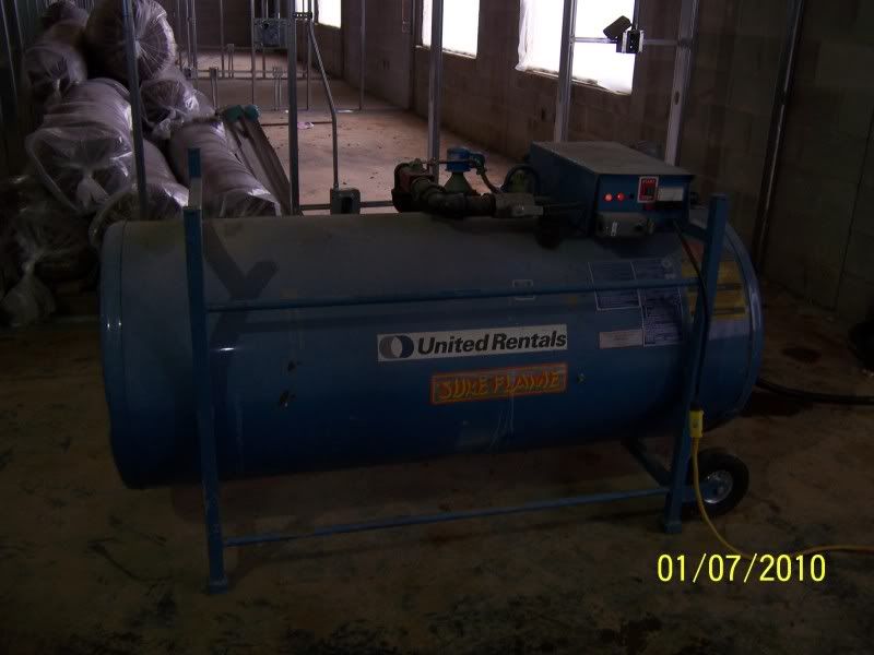

I bought this propane heater used at a sale a few years ago, and have used it on several jobs. It's a Sure Flame model 1505, 1,500,000 BTU, and puts out some serious heat. It has a two stage operation, seems to work fine on low flame, but on high flame it will burn for 4 or 5 minutes and shut down, as if it is starved for fuel. I have it hooked up to 3- 500gallon propane tanks and all tanks are full. Don't know much about regulators, but the guy from the propane company changed the regulator this morning, didn't help. He says I have 10psi at the tank regulator (it's red) and 1/2psi at the heater regulator(it's gray). It puts out plenty of heat on low flame, and I have used it that way for several winters, but need the extra kick occasionally. Any ideas what I need to check? I'd say this problem is why United Rentals put it in the (as is) equipment sale.

That's much larger than anything I've had occasion to deal with, but the first thing that comes to mind is that perhaps you have an undersized supply line. This manual for a similar model suggests exactly that for such a symptom.

Yeah, in fact me and the propane guy called Heat Wagon and got a tech support guy on the line, he suggested the same, but that hose that is visible in the picture is 1 1/4 fill line hose, recycled from the propane delivery truck. DOT reject it when it gets a little bit of wear, so they use it for this kind of installation. Plenty capacity according to Heat Wagon. Last year I had it hooked up with 1/2" supply line, and it did the same thing. I was hoping the 1 1/4 would fix it.

Yeah, I noticed the size of that hose in the pic, but straws are for grasping at. :laughing:
The only arrow left in my quiver is... perhaps the high heat creates enough of a draft to divert flame from a thermocouple, thus shutting it down because it's not sensing enough heat. Ran into that with an unvented space heater once.
If you do ever get this resolved, I'd really like to hear what it turned out to be.

I'll let you know. I got a repair guy from United coming to take a look tommorrow, I suspect he will leave scratching his head. Next step will be to call Heat Wagon back and see if the have a local factory rep/ repairman any where in the area.

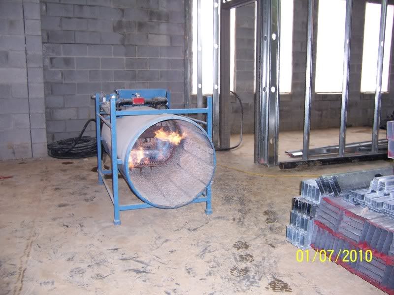

Yep. Here is a picture of the tank farm required to supply the required volume. It's not something you want to run 24/7. But it is the only thing I have found that will heat a building up to spec for painting, VCT, etc in the kind of weather that we have been having in our area lately. Project managers hate to see it show up on the job and the propane bills start rolling in.

i realize this is a tad late, but you may need a vaporizer between the supply and the heater. google propane vaporizer. good luck
