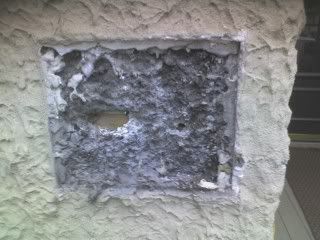

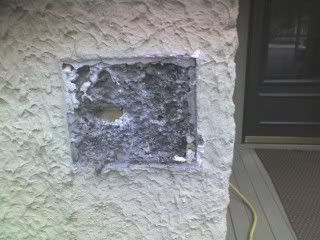

Okay this is probably one of those stupid questions BUT here it goes anyhow:
I have two 10"*1.5" deep stucco areas to patch where a railing frame was attatched to an exterior wall, since this is not my area of expertise or anything, just wanted to get some info how do you get that design, techniques, tools, and product info, thanks. I was thinking using wire mesh and a product from HD, and a trowel and dipping into the stucco trying to create this design, any tips to do it the right way and how I am planning on doing it wrong would be appreciated .
Here are pics:

what is the grey material?if it concrete,i wouldnt mess with lath.just clean up the area with a grinder and apply the patch.
Okay thanks, but how do you get that stucco pattern? Any certain tool or just a trowel?

Okay, sorry about that, here ya go, I found a good thread on CT that provided me this info, here it is: http://www.contractortalk.com/f11/old-stucco-patch-59010/
This was the info I was specifically looking :
"for It is either gunned on or a pull finish where you take a trowl put some mud on it and pull straight back will leave big pointy texture That kind of hangs."

But the best info I just found with a google of "scratch coats", (too bad I already put on the first coat) with mixes and such, is from this site:
http://www.cement.org/Stucco/faq_coats.asp

Here are some pics, I think for an amateur they came out pretty well, owner will paint them later.
Nice match. I was going to say "practice in a piece of plywood" but looks like you got it down.

I was just wondering what did you use to do the patch?
QUIKRETE QUIKWALL Surface Bonding Cement in two coats, (tar paper than wire mesh) they also have other stucco products or I believe you can make your own by following the ratios on this site http://www.cement.org/Stucco/faq_coats.asp
