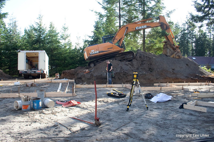

Work has been slow this year, but we signed up a custom last week, and set up footings today. We've got a little work ahead of us so we hired Kyle back :thumbup:
It has been super soggy here the last week or so and today we got a nice break. Sunshine all day and made good time on the footing.
We started forming around 9am (after finding all the foundation gear and getting to the jobsite) and left at about 2:30 with it ready for inspection. Just 2 of us until the last hour then my brother showed up and tied some bar.

looks a little wavy tim :whistling
seriously though, are the footing just laying on grade or is the picture deceiving?

What that is is the forms offsetting at the laps. Although I should check it, I didn't level that side and didn't think to check Kyle's work.
The footings are raised off the dirt to give it a depth at the min 8". We have the grade sloped and put a pipe under the footing at the lowest point so that if the crawlspace gets water in it, it'll drain and not just sit there.
I cropped the picture to show the footing. I took it before it was brought up to grade. The form isn't totally nailed together until after it is brought up. I put a stake next to the single nail in the overlap, it acts like a pivot. After the forms are levelled, then the lap is nailed tight.
I always wondered why,in the wettest state,they use wood floor joists on the first floor and don't pour slabs like in the south.Soil conditions?Too much clay?

I don't think I'd want to trust anyone to prep the concrete work correctly on a slab on grade. Seems here that moisture could come through the floor.
If the soil is so bad that a crawl will flood, then a curtain drain will be installed around it. But I've not heard of problems like that in this area specifically.

Not where we are. No frost heave. I'd have to look it up but we dip into the upper 20's a few times a winter. Avg lost temp is mid 30's and highs mid 40's. Pretty moderate.
i'm so used to everything being dug in that something laying right on grade looks waaaay odd to me :eek:

You guys need to relax about the footing depth and soil conditions. I used to live close to where Tim lives and this is absolutely the norm there. Actually it looks like he has some sand down which is a luxury compared to what I had which was what we called walking in baby ****.
Just like Tim said, there is no frost line. Pretty much the whole west coast has no frost line.
Soil conditions in the Pacific NW are clay. You dig down and anywhere from 2' to 8', you hit hardpan which is like hitting ledge. You cannot move it, but it still gets slick when it rains.
Place a piece of plywood on a juicy muddy spot for a week and it will be quite solid when you take it up.
We backfilled with the excavation many times. What a mess if it rained alot. You'd walk along and not have a clue that a sinkhole was right there.
