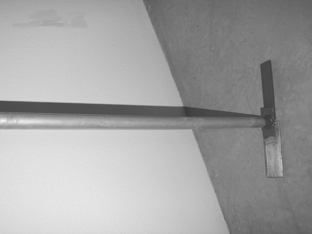

This should work for stirring.
Or make your own with some steel pipe and a mower blade cut in half.
