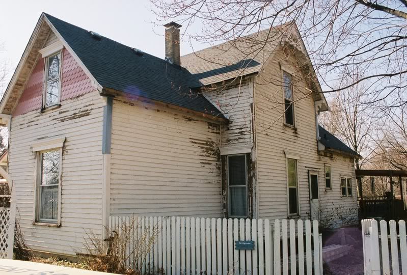

This old girl was in pretty rough shape on the outside when we started. She needed a new roof, gutters, soffits rebuilt, siding, windows and a patio door. She got it all and then some....

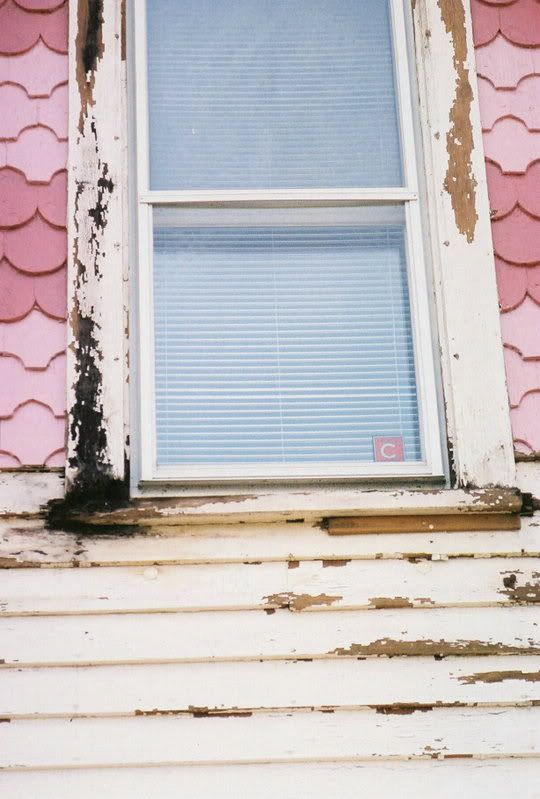

Now, here we had removed all of the old aluminum. Underneath the aluminum in the gables, there was some beautiful fish scale. Some of it was in pretty rough shape, but the HO went ahead and did some paint and color testing on both the gingerbread and house color. As we were tearing off the siding, they painted the gingerbread and detail around the porch in the same colors to make certain they liked it. We ordered special "paintable" shapes to replicate the gingerbread in the gables. You can also see we're just starting the window treatments over the windows.....

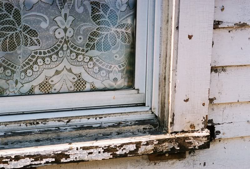

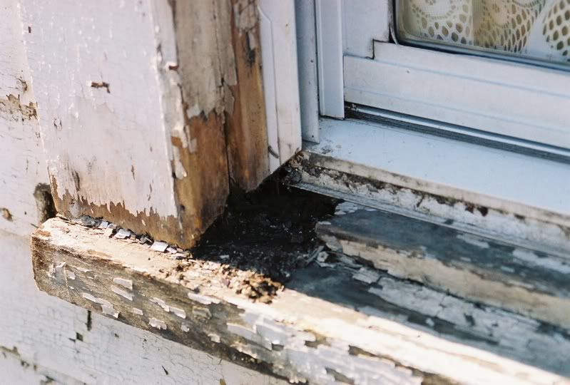

A lot of old wood rot needed to be addressed for sure....

She already had some really bad replacement windows which were poorly capped. The capping leaked and caused all kinds of problems....

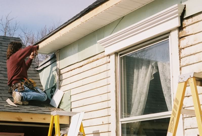

Starting from the top down, the roof is done and we are rebuilding the soffits....
Rebuilding some of the window openings, with new replacement windows in place.

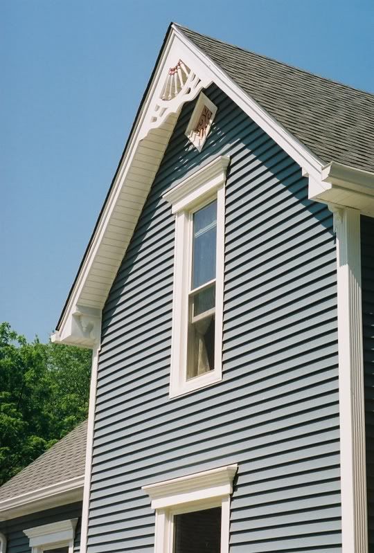

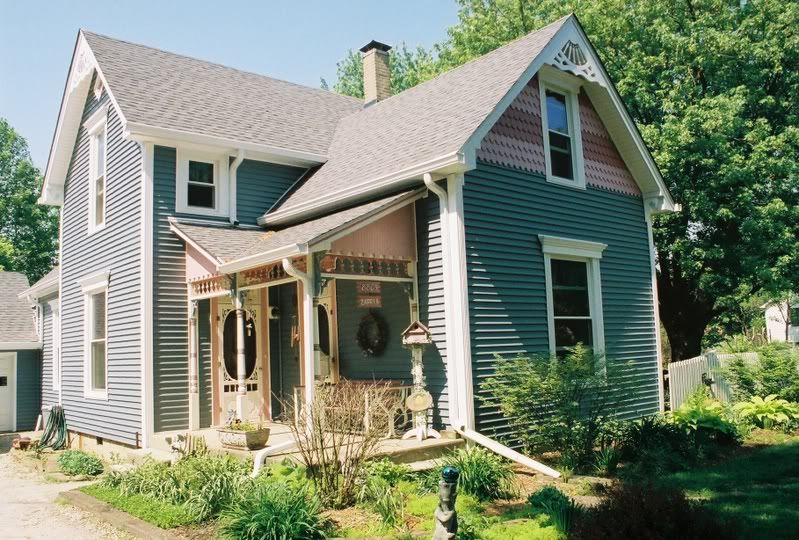

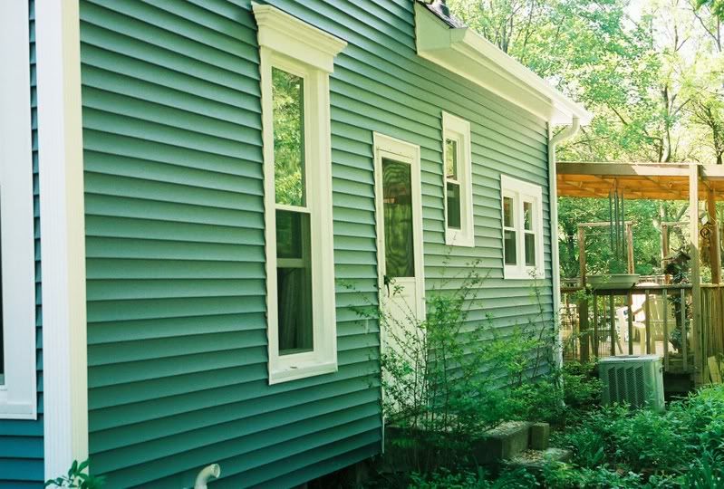

Again, I'm incredibly remorseful that I didn't get more pictures. A lot of the "during" work was done while I was going through some health issues. But, here she is complete.
Quite a stunning transformation when you consider that a couple of months before, she was covered EVERYWHERE in white, faded, chalky aluminum.

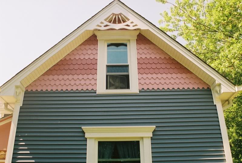

Notice the Corbels on each side of the gable and the gable pediment? They eventually got trimmed and painted with the same mauve, pink and blue color scheme. They really look sharp and stand out nicely.

Like I said, vinyl would not have been my first choice of siding on this house, but that's what the HO wanted. So, we had to make sweet lemonade out of those sour lemons.

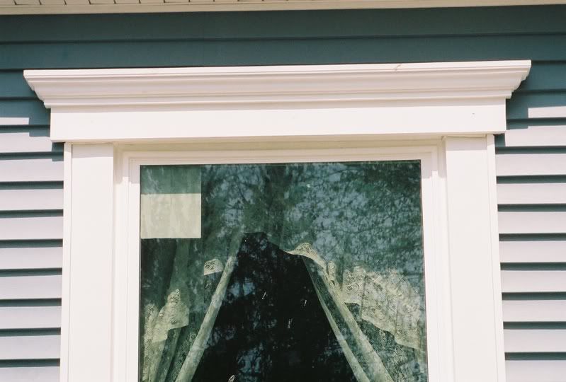

I think using the 20' fluted outside corner posts, the window mantels, gable corbels and pediments, along with the white j-channel around the windows blending in with the wide wrapped casings.... helped out a LOT taking away the typical "vinyl" siding look.

What product did you use for the scalloped area?

It's a product I've used MANY times. The company used to be called Miami Foundry. All they make (or used to make) were scallops, shapes and various shakes. What I really like about them is they have a pretty large color selection, have paintable versions, and more importantly, they are designed to hang like siding. It's nearly impossible to find any seams once the product is up. You simply can NOT find them looking straight on.
Quite unlike some of the products like the CertainTeed stuff, which goes together like a jigsaw puzzle and is REAL temperature dependent on where you float the overlaps. So much so, they used to put a digital stick on thermometer on the back of each piece. If you didn't get it perfect, the seams and overlaps would show up and stick out like a sore thumb whenever it got really hot or cold.
Anyway, several years ago, Miami Foundry was purchased by the Mid-America/Tapco group. They changed the name to just The Foundry. I was worried that they would change everything, but other than adding some REALLY bad looking stone panels, they've left all of the MF profiles intact.
They use over a HUNDRED different molds. So, IMHO.... they have some of the best, most realistic looking shapes, scallops and shake panels on the market.

Thanks.... Shane. It was totally their choice for sure, but I thought it worked too. The only help I threw in, was the choice of roof shingles. And as it was, the roof they ended up with, was only my second or third choice.... LOL
FWIW, the siding is from you Cannuks. It's a Royal - Journeyman Select panel. Pretty nice stuff as vinyl goes. The roofing is from Tamko called Rustic Slate. I really thought I preferred a little lighter shingle in the OC Oakridge Sierra Gray, but the more subdued medium gray ended up looking very nice as well I think. The lighter OC color may have drawn more attention to the roof and possibly "competed" with the rest of the bolder colors of the house.
