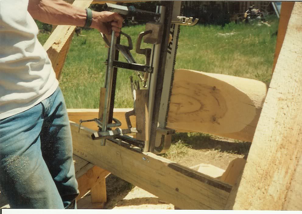

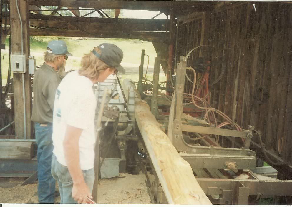

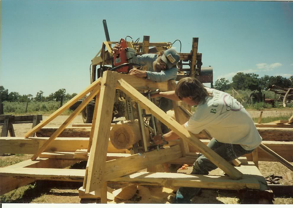

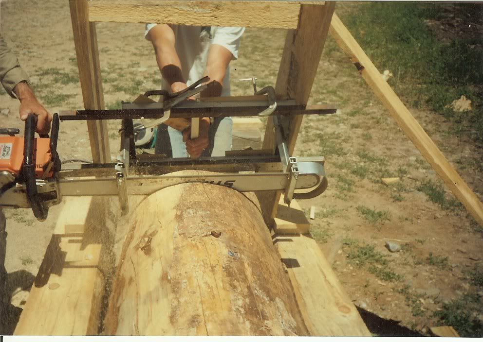

Here is how we got the back cuts for the t&g
This got the top cuts
This got the top cuts on the center log
This got us the flat surface on the bottom to rest on the center log. Got the consistent height too.

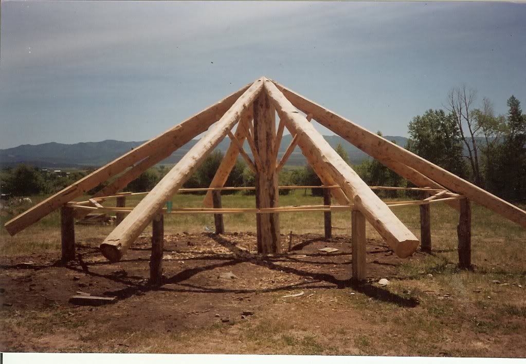

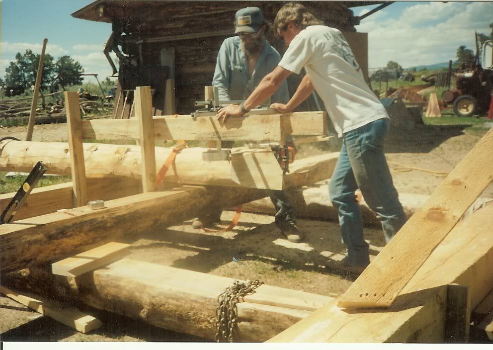

The whole thing was mocked up off site at Bob's house

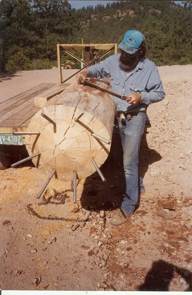

This is Bob and his homemade draw knife. Awesome guy, couldn't have done it without him and his mountain man ways.:notworthy
There was other work with the round stock too
