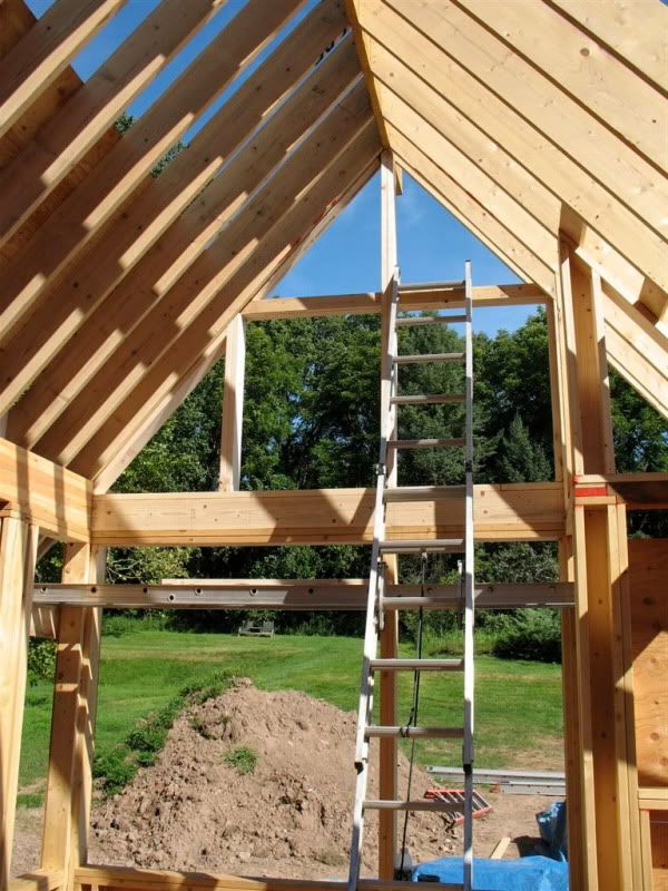

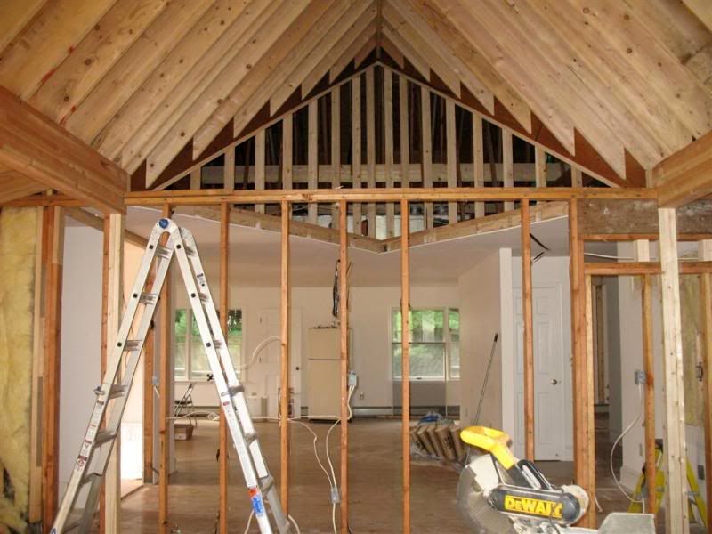

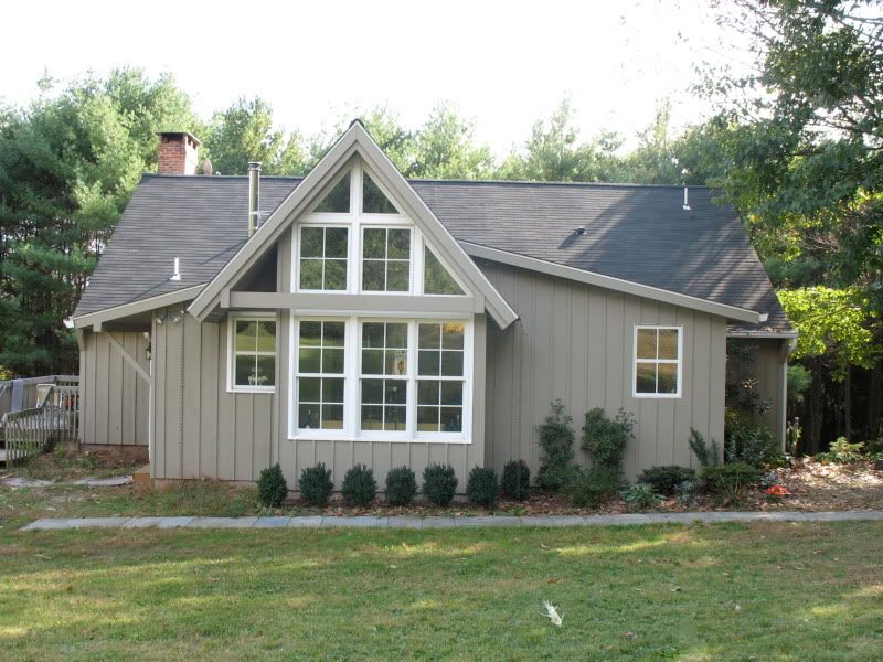

my first house finished is amazing with those timber trusses in the gables. :thumbup::thumbup:
some shed framing:rolleyes:, im gonna start framing houses and my deck in the next few weeks so stay posted:clap:

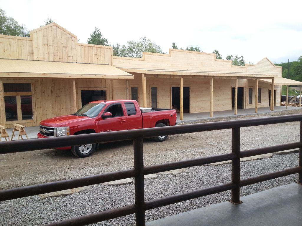

Heres a garage I did recently, first time I've had a crane for trusses. Watched the crane drive by on the road and miss the turn, so we waited while my boss tried to get ahold of him. Then when he got there he didn't have enough pads to get level enough in the driveway. Then had to wait another hour and half for those to show up from the city. The day was about 5 hours longer than it should have been.
