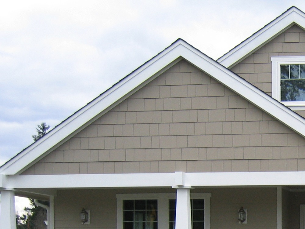

No I haven't. This was my first Hardie shingle of any type. I have done different types of cedar shingle and fish scale.
The lumber salesman suggested not using the type you mentioned. He said most installers weren't too happy with them. He pushed these instead. The builder, PM and HO agreed. I just shot them into place.
They came in 12", 8", and 6" widths. The problem with this 12 year old tract home is that the mega-builder/developer had the framers push the gable truss out 1/2" and not sheathe it. Then they originally ran that masonite looking shingle type siding directly on the truss.
I had to sheet the truss, as per Hardie shingle installation instructions (duh), which then meant that the "belly" band (as they call it up here) had to be 1 1/2" rather than 5/4" so that the shingles wouldn't hang too far past said band. Up here we have cedar all the way up to 24' - 2x12 so that's not a problem. We went with cedar because the option of 30' of 8" x 1 1/2" Azek made the lumber salesman laugh too hard. (I still don't know if they make it in that thickness or it would just cost beyond any form of reality)
Definitely use a frieze board, if you are going to the expense of shingled gables don't cheap out.
Nice!:thumbsup:
I think shocker was talking about a frieeze board against the soffit, not a horizontal band.
Yea using my terms I don't see a frieze board on that house. Someone went cheap.:laughing:

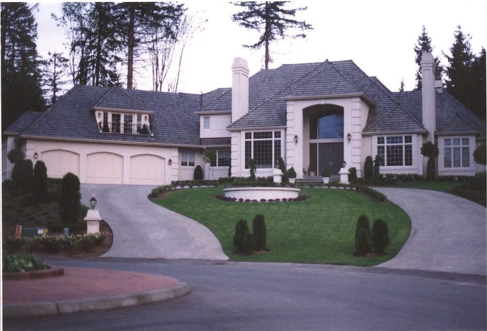

Maybe it is the angle of the picture, but it is there. See enlargement.
I think there is a frieze board on this one too. This pic has a better angle.
This pic is not that great, scan from a pic from cheap camera in 1990. But a better angle to see the frieze board.
6

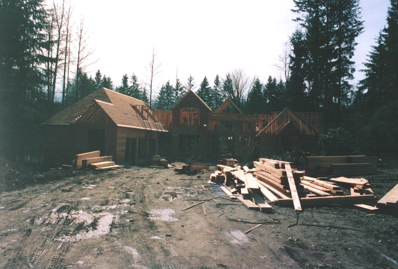

More pics from 1989-1990.
I think I know what a frieze board is or at least what they call it around here, since this is what I was building 20 years ago. A frieze board around here is the board flat on the wall under the rafter tails or under the rake of a gable up against the soffit and flat on the wall, and which the siding butts up to.
Certainly no offense meant, KG. Nice work.
Found a pic of the next to last house under construction I posted earlier, finished.
