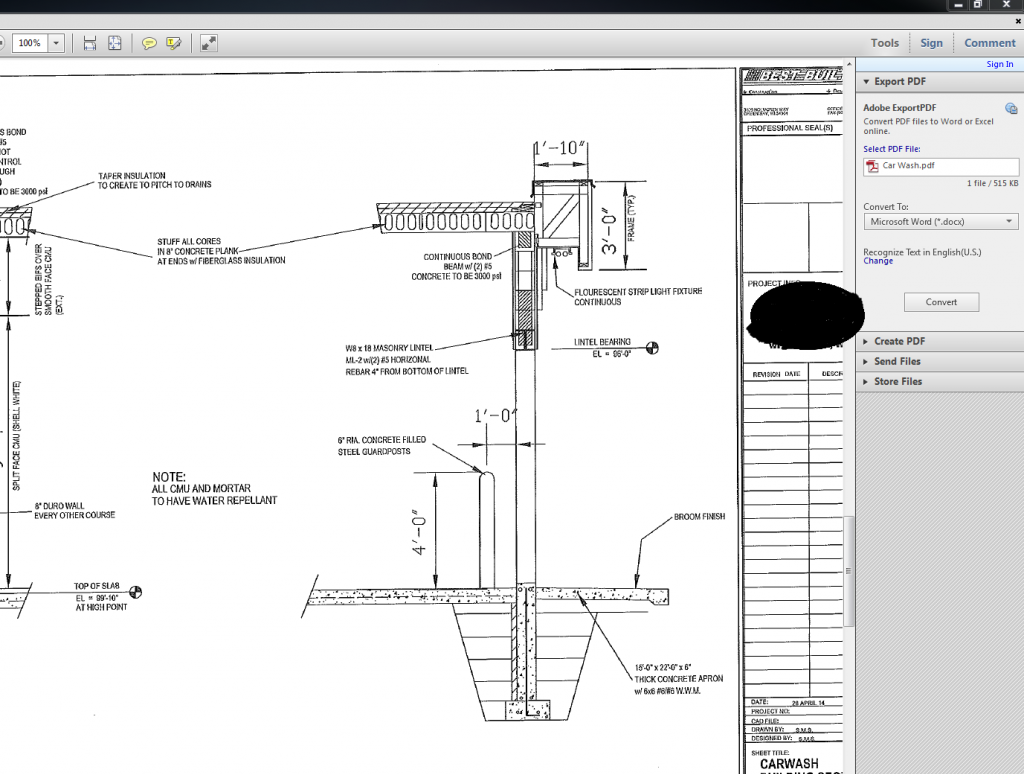

I have this set of plans, and normally I dont do commercial, but I'd like to start expanding a bit, and start doing more of this.
The blueprint here has a call for block lintels 8x18, and shows what looks like an I beam of sorts to be used? Am I seeing that correctly? They are for openings for a car wash.

Yep, looks like W8x18 I-Beam lintel. Typically on commercial projects the mason will not include the cost of lintels in your bid. You will install them but not furnish them. The steel fabricator/supplier will furnish all steel on the project....lintels, bollards, embeds, structural, joists, decking, etc

It is very typical for overhead door opening. There may be another page with lintel details. But most likely it will have a plate welded to it at the bottom.

That is a very common detail. Couple ways this detail can go depending on the steel. The height and width of the steel and if there is a flange welded to the bottom.
Assuming the steel is 8" tall. And you're using regular CMU. Order some 2" or 3" block, depending on what will fit. Lay the block on each side. If using a decorative block and depending on how many you need. Cut the block into slabs.
If the steel is 16" talk double your order. If it is 12" tall. Lay one course of the slabs on either side and a course of KOBB upside down for the second course. Also be aware that there is mostly likely Nelson studs welded to the top to add additional reinforced cells above the opening.

Also if there is additional reinforced cells above the opening. Pay particular attention to isolating those cells so that the grout does not run into the beam and blow out block.

We call those "soaps." You will have to lay those one day, then let them set overnight before grouting. Usually, we would lay one course of the soaps, the turn a bond beam upside down for the second course. Still allows access for grouting.

Ask the architect/engineer to review the drawing and consult with his Masonry "Rabbi"
That detail is ca ca.
Ungrouted soaps on the W beam, # 5 bars 2-4" above W-beam, Nelson studs as needed drive on.

NJ Brickie, NEVER seen the soaps grouted or re-bars place inside soaps on a W-Beam. Would you weld Nelson studs to both sides of the bottom of top flange & the top of the top flange for bonding?
