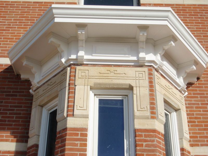

All the tips have been covered. I have found nothing to reseal the ends up to my standards. I like to use a combination of glue. The Azek brand glue I put in little glue bottles to make it easier to apply. But it takes a while to tack and cure so for that reason I like to get the joints set with CA glue. Holding it in place until the Azek glue cures.
Here is a picture of our azek work.
Cole
