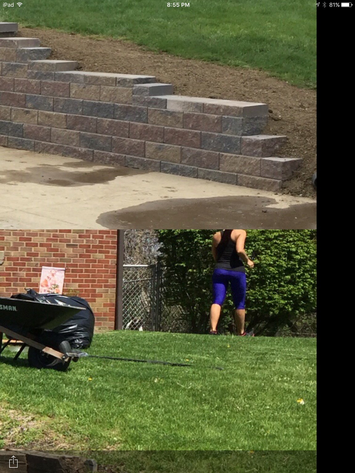

Picture of just a tiny project of what I do.
