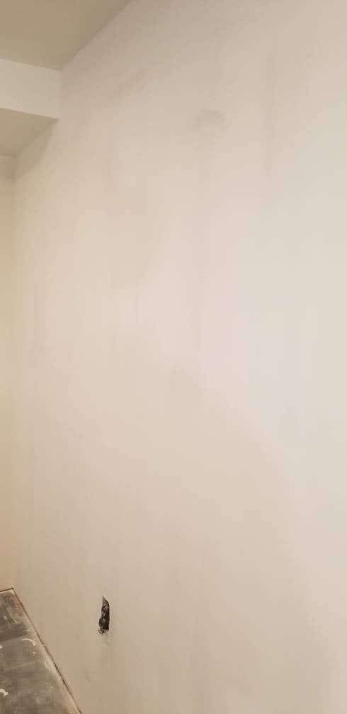

I recently have been having issues with my planex easy. Hard to tell from the photo, but it seems the head is leaving ridges to one side each pass. I feel like I am keeping even pressure, any suggestions on ways to eliminate this?
220 grit, standard head, hooked to ct 36 e vac

Picture of the texture please.
I've removed a lot of popcron from ceils using the Saphir 36.
Make a wedge that holds the vacuum lever on the head 50% of edge/center. I wish there was a setting on the head mid way, it provides the best dust collection.
Use the nornal Granat 80 paper to remove the texture, finish with 180 or 220.
