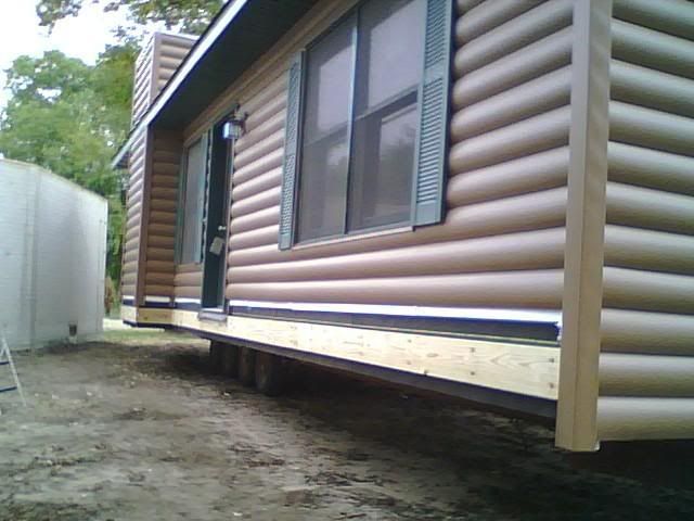

Here's what happens when you discover a fricken HOME BUILDER builds himself a home in the county with minimal code with intentions of reselling:
We ended up stripping the entire house and completely redoing the exterior...replacing plywood and all....homeis not happy, nor were we.:furious:

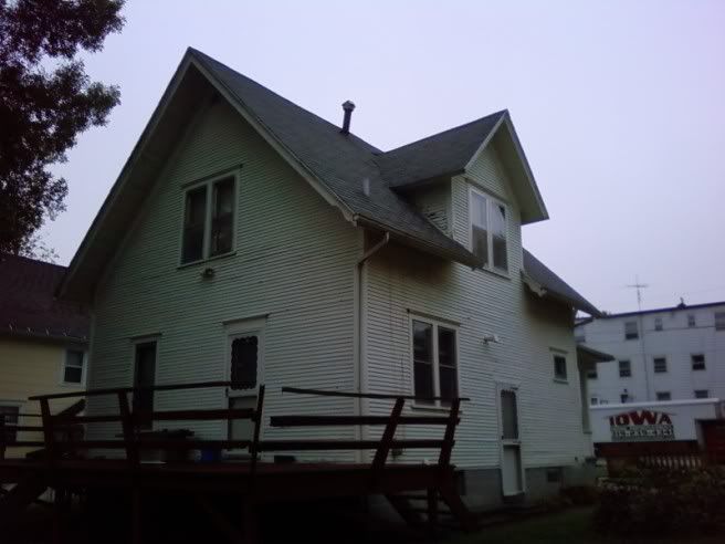

I did too.....but check out the back:
All the framing was the same throughout, they did'nt cheapen the front up just because it had some 2x4's out front....when i removed them, they were'nt even nailed into the fascia, so all i literally had to was pull them away from the fascia and they dropped down. These "decorative" pieces were only held in by 6 8D nails....you read that right. Same as the porch "wall" sections that we ended up tearing completely out and rebuilding because the sections between the posts were toe nailed in with 8d nails...2 sections at least had a concrete anchor, the rest did'nt LOL!! That house is a POS to be honest, was'nt anything built good like the houses i know your referring too...this musta been an Amish built house or a mexi built hosue back in the day:laughing::laughing:

LOL, there WAS a deck in the bid but unfortunately that was one of the things we had to 86 from the game plan due to budget. Same with paving the driveway and actually doing the labor siding the garage, i sold them all the materials but they put it on themselves.
What kinda made the deck spendy was the fact the backyard DROPS like a rock, I calculated 18 steps to get down to the garage on a straight shot, and had a few designed figured with landings to break it up a bit since grade was so drastic out back. Plus i always try to figure decks free standing so i know there will never be a chance for water infiltration even though we go overboard with flashing and ice guard prior to putting ledger boards up when we do attach them...i just prefer the free stander for my lifetime piece of mind...so there was more peir footings/cement than a typical deck.
I like running ice barrier up about 10" above threshold, then prior to setting decking boards i bend aluminum flashing and stick that ontop of the ledger as well to help prevent water from getting trapped between ledger and ice barrier
