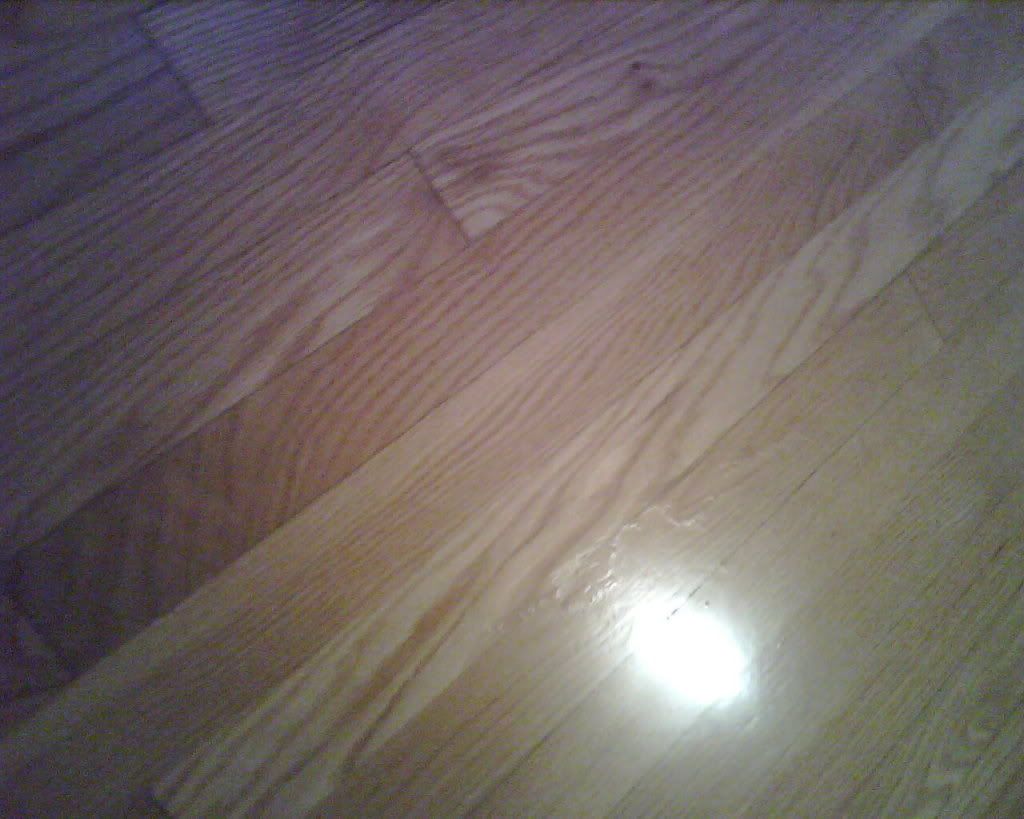

Hey,
Had a big lap that didn't flow out. Let it dry. Sanded it. Scraped it, sanded it but it was gummy. This is what I got after doing an extra coat. I know I know. What should I do now? Sand with a fein, mask off and brush on finish is my best thought.

If it was gummy it wasn't dry. You should have waited until it was dry and recoated. You can always scrap with a razor or card scraper to bring it down level and polish out. But again, it will need to be dry. It'll probably be tough to polish it and get the same sheen as the rest of the floor.

These types of repairs are always difficult, taping off is the way to go, carefully sand out the area, tape off to all seams, reseal.

thats an easy fix..its only across 2 board..
completely stencil out the 2 boards with tape..scrape the heavy ridge out.. hand sand until feathered off and flat...
clean and brush in the same poly...peel up tape and walk away......
can always risk slight sheen variation, but more often than not, we get a nice blend..
if you have the same can you have been working from, that would create an ideal touch up.

Thanks everyone for your feedback.
Yes it was guymmy when I initially scraped it. The job was a rush, for a large repeat client (a property management company) and the work had to be completed by today.
I did what everyone recommended. Sanded it with the fein, 120 180 grit taped and then apply poly from the same working can.
