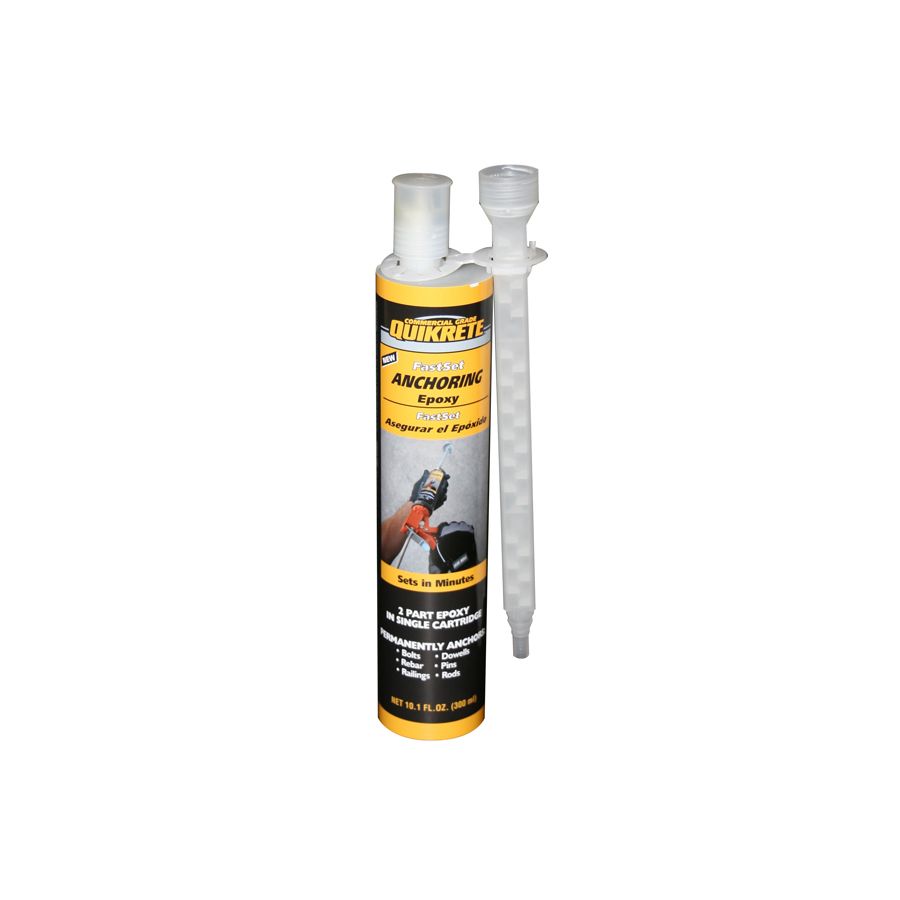

I sometimes have to sink only one or two rebar dowel rods vertically or horizintal in a wall. My code requires I do so with Epoxy 2-part. The tubes come with 1 tip that mixes the material together and applies with a caulk gun..the tubes are $18-22 each. I hate having 85% of a tube left and a tip that is useless now. I wind up mixing my stuff on a piece of cardboard and a shim for the next couple of small jobs and have to somehow squeeze it into the hole..not too bad vertically...miserable on a horizontal dowel..
Anyone know where I can buy extra tips..I have searched online..searched Quikcrete.com website for spares to buy..I am reaching out to you guys for some help.

On jobs where you use multiple tubes, use one tip (or as few as possible) and save the rest for occasions like that in your post?

You really don't have time to screw around, leave a hilti tip for 5 min on a hot day and it's rock solid.

Problem is I am not a concrete only guy..I do concrete occasionally..big jobs I sub..small little knee walls ( this past week) I handle or the slab that needs to tie in to existing in one small area is where I run into the hassle of throwing away tips on half empty tubes.

Wrong application then, order a box of UCAN HammerCaps:
http://www.ucanfast.com/products/details.php?category=Chemical+Anchors&c=3&subcategory=Anchoring+Cement+%26+Glass+Capsules&sc=176&productid=137
But it you are convinced otherwise hilti sells them....not cheap though and they may not fit.
https://www.hilti.ca/anchor-systems/dispensers,-accessories,-testers/284267
The hilti tubes come with 2 tips, if I have any left I shoot it into a zip lock bag and pipe it in.
I just bought a dozen 1/2" ( UCAN hammercaps) off ebay for $16 with freight..thanks for the info.

I have the same problem and the same problem with silicone. I charge for the whole tube and toss it after I'm done. I hate waste but I hate messing with stuff a month later that isn't worth the time.
Have you tried calling Quickcrete? You never know...they may send you some.

good idea but I find all the the straws are proprietary to the brand. I only use hilti. They just repackaged the 10oz tube to the dbl separated 2part due how I am set up in there system I only pay $8.50 each and buy 50 -100 at a time. I used to pay $17 for the $23.00 10oz tube. We use miles of that chit. They too come with 1-straw. Just ask them for more they usually give a dozen or free. Try and find hilti store.

Are you using HFX? I have an HIT gun, it's cheaper, less waste and dispenses better.

Keep the hardened tip as a cap, remove it, and squirt the unmixed adhesives into a Ziplock bag. Mix it , tie it off, and if you pull on the baggie end instead of cutting it, it will elongate then break into a perfect dispensing nipple. And cost about .15 apiece.

If you're only doing small amounts, RedHead Ramset makes a Derringer kit.....as I remember it's the C6 epoxy, and comes in small, maybe 2-3 oz cartridges......they sometimes show up on ebay for short money.....all of the parts can be bought separately, and are fairly inexpensive....
