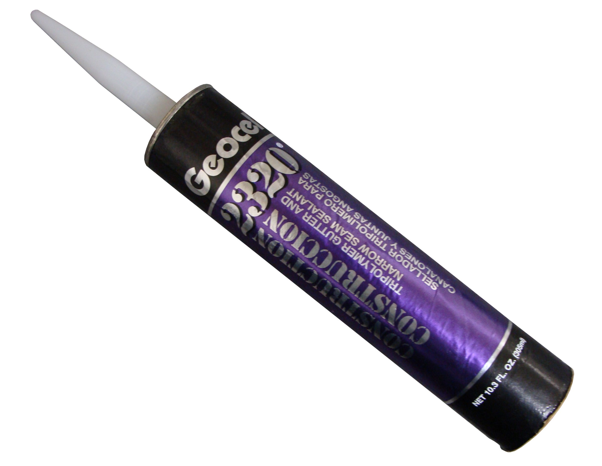

The gaps can be repaired, not permanently, but remedied QUITE well with NP1 or GEOCEL 2300.
The application process is PARAMOUNT to the longevity of the fix. You can use a bitumen primer to help in the adhesion (this is NOT a standard practice, but it has served well for me in the past)
http://www.amsisupply.com/graphics/sealants/sonneborn-np1-large.gif
http://www.geocelusa.com/core/prdb/public/php/get_image.php?image=prdb_product_full_image_7.jpghttp://www.guttersupply.com/file_area/public/file/geocel sealant 10_3 oz.jpg
