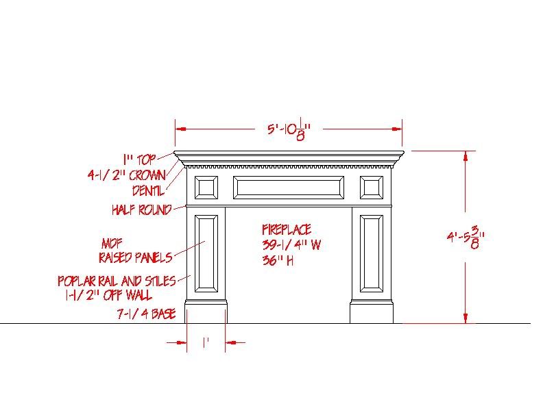

i picked up a real nice job today. a 13' built-in with a desk, the fireplace surround, and crown in the whole room.
the home owner had a magazine pic of what they wanted it to roughly look like. all paint grade. she wanted dentil, that was all she was concerned with.
the fireplace is a sealed gas unit, zero clearance.
#5 ·
Ok, as you are asking. My opinion is just that, and since the drawing doesn't show the fireplace in context with the room - ceiling height, wall space, windows near by, other architectural details - this is what I think :whistling subject to not knowing what I'm talking about :laughing:.
I like to see a flat detail around the heat source - could be 4"-6" wide of flat. Could be wood boards or tile or even a series of wood square tiles, but all kept within 1" of the face of the zero clearance heat source. Then I would scale down the width of the columns. With the flat that I described the column heights get taller and more slender and so the header gets scaled down too. The mantel gets set up a little higher and in this case I think it could have more mass. I admit that I would be more inclined to have the columns carry the mantel terminating in a cap detail with a header panel set between, BUT I like your basic idea as drawn - just go narrower.

its on a 45* wall thats not much wider than the mantle width and the ceiling is 8'11"
i am going to have to measure the 45* wall again to make sure i got the right dimensions, my notes were kind of sloppy.
i will play with narrowing it up a bit this weekend and see what it looks like.
thanks

At least draw in the fire box.
When you introduce that rectangle into the mix, the size and height of it will have a huge effect on the proportions of the mantel.
Or go with what you got, it will probably look fine. But we can't be sure.
#13 · (Edited)
without a flat area off the firebox you are going to dwarf the fireplace. Especially on a 13 foot wall. I would seriously run this by the ho. It could bite you in the end. just looking out for you.
here is a pic of what im talking about. Built this a while back. Very minimal flat on the sides of the fireplace. Now imagine bringing the top down to match the side reveals. Would look like poooo
#14 ·
the firebox is the opening i have drawn.
the fireplace isnt on the 13' wall, the wall is only a little bigger than the mantle.
i have a built in desk along a 13' wall.
the pic you put up is almost exactly what is happening, just not as far out from the wall.
i am going to work on tuning up the drawing a bit with the sugestions i have so far.
thanks all

I made the mantle/ surround.
It's getting painted after its set. I might redo the top cause i think its too narrow but others wise I am pretty happy with it. I did take the suggestions from here and ran a little flat wood about 2" wide around the fireplace.
#29 · (Edited)
I put the pics in show us your work thread in general, but here is the finished product
Btw: who ever said to put the flat stock between the raised panel legs and the fp, as you can see I did that and the ho's both commented how nice of a detail that was.
