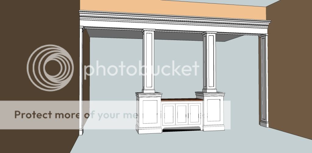

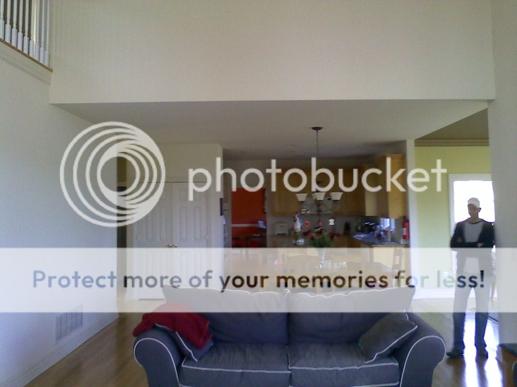

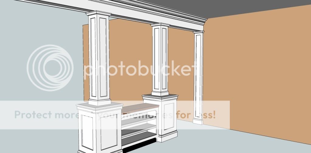

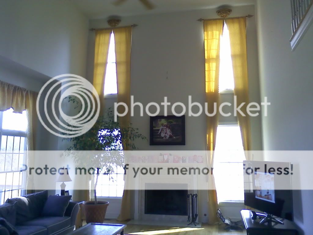

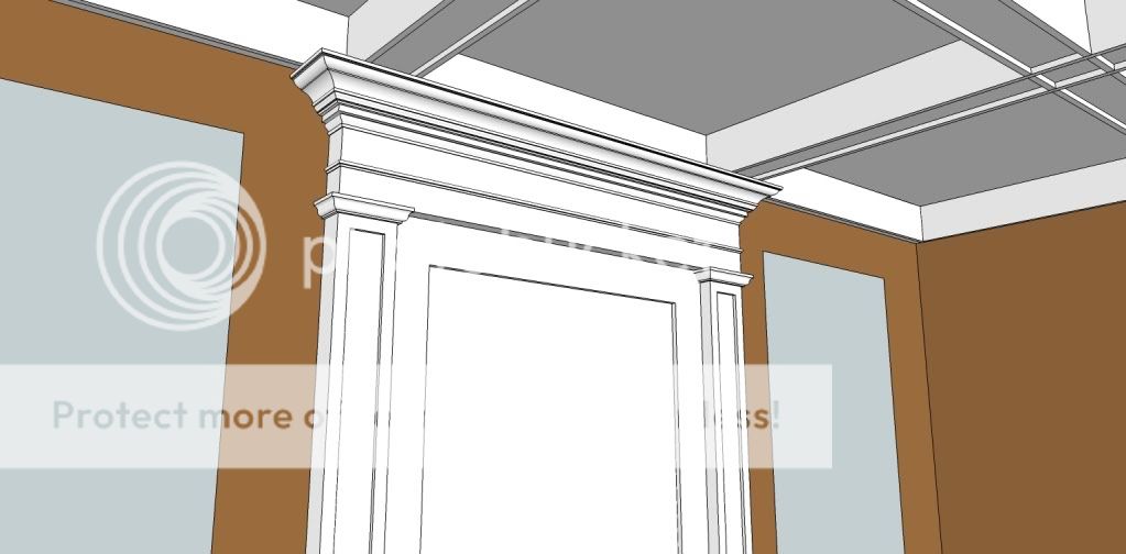

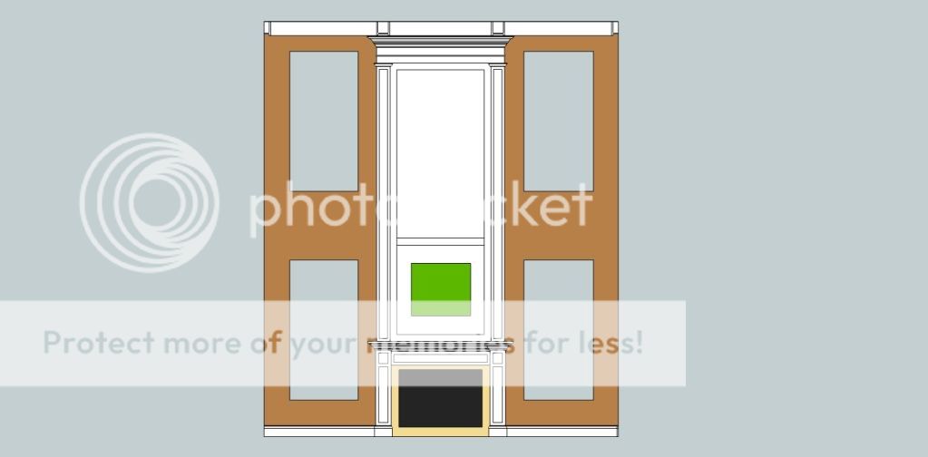

I have the next two weeks off from my "primary" employer to complete a living room re-trim. We plan on wrapping up some of the shop work this week and doing to install all next week. This job came from word of mouth and a visit to his neighbor for which I performed some work about a year ago.
http://www.contractortalk.com/f30/foyer-trim-out-96974/
Current Space
Images client supplied as a general idea/inspiration of what they want
Proposed Designs
