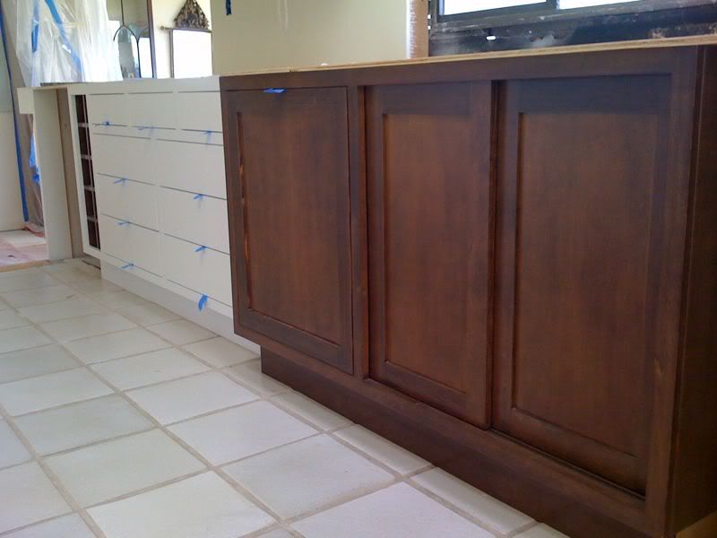

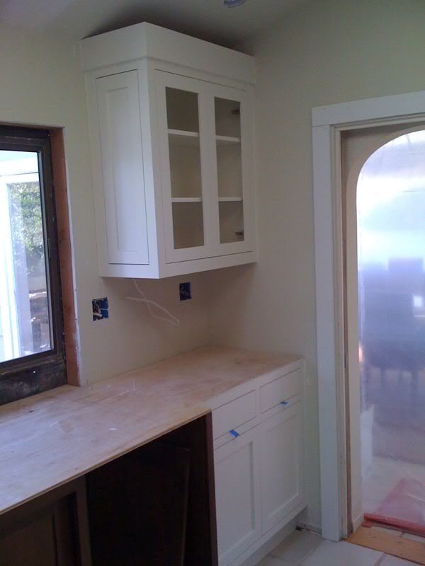

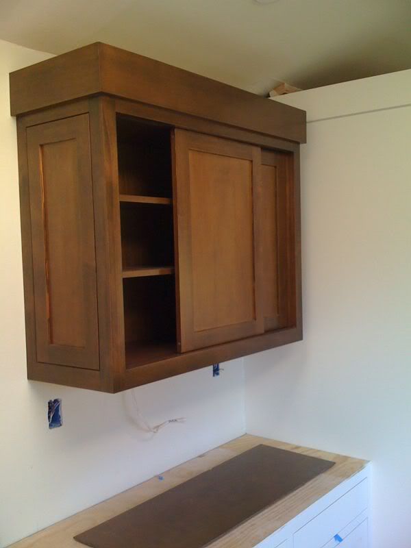

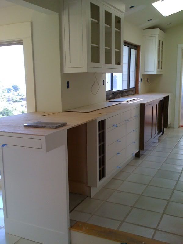

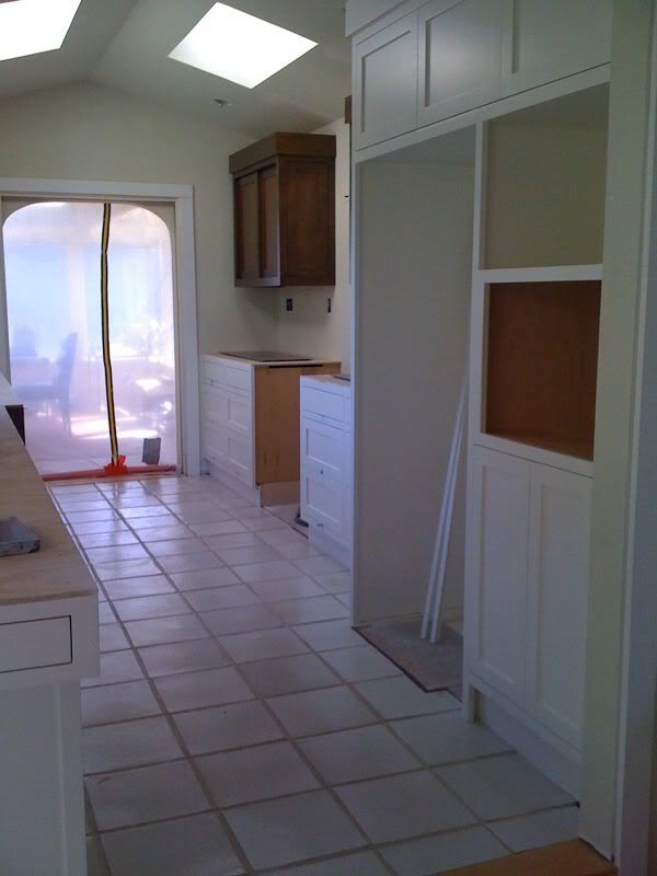

The painter finished up today and I made all the final adjustments on this kitchen today.
Can you spot the quirks?

Quirks?
Well, the outlets are too high--but my guess is you're referring to the cabinets?
Sliding doors are definitely different. Toe kicks look a little taller than standard. The plaster arch, with a squared cased opening on the other side is definitely strange. Pocket door?

1st picture, there is no glass in the cabinet doors. The panel on the end run is over the step into the next room. Stained and painted cabinets above and below each other. Still a lot more work to do in the kitchen.

These pics were taken today. Yes there is alot of work to do but not related to the cabinets. I was responsible for the paint job on the cabs only.
The kicks are 5" tall, good eye there
Stained and painted cabs, blind man can see that.
Sliding doors are quirky, easy one
I think there are a few more.
Yes wine fridge at the end of the line.

Toe kick recess is shallow to the right of the fridge... ?
I'm guessing stainless hood? Where is it ducting?
Yes shallow kick as we had to cover to the existing tile.
Lets limit the quirks to the cabinets. The GC has his own quirks.:laughing:

I see the panels... I'm assuming these will accept the undercabinet lights...
I'm curious about the counters. That ply looks way too well aligned to be temporary.
Very good grasshopper. Those panels on the counter will get drilled for puck lights and nailed on the bottom of the uppers.
The sub tops are 5/8 cdx cut on our slider. Sorry they look so nice.:laughing:
No dishwasher?........or do we just throw them back in the cabinets and save water to put out wild fires :furious:
You are a funny man.:laughing: Wish you would hang out more with us.
Dishwasher to the right of sink, panel leaning in the opening
