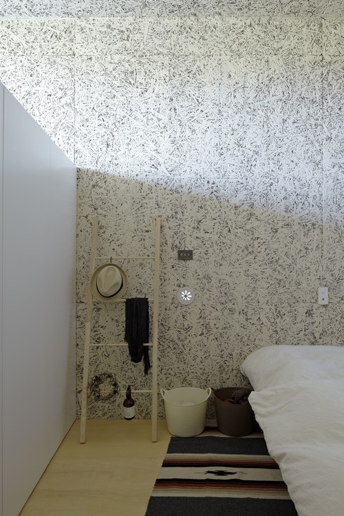

The house is built with Sips panels so the whole interior walls are OSB.
Trying to come up with alternative ideas to finish them, to avoid having to hang sheetrock or something else. Any ideas are appreciated.
My first thought was to maybe have the walls skim coated or painted where the osb chips don't show thru
spray a texture splatter coat and knock it down

the point of the thread was ideas to avoid drywall,
that what the client wants.
input along those lines are appreciated.
so far they like stain with white paint over for the ceilings.
Yes they will save money doing that way, if fact the roof panels can be stained & painted while on the ground super fast before hoisting up.
No scaffolding etc only thing to do is caulk the seams, but the 10 roof panels are 8' X 18', not that many seams.
