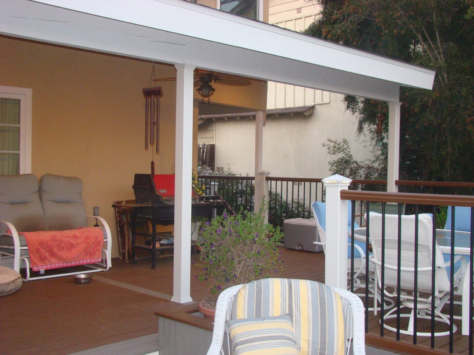

#63 ·
I have never seen these and I'm having trouble visualizing it for myself. Do you have a picture? I would love to be able to avoid diagonal bracing to give the deck a cleaner look and more durable racking resistance.
Sent from my iPhone using Tapatalk
#20 ·
Actually Mike. I install the brackets on the decking not through it. Grace tape on the bottom for isolation .
You got foundation, solid framing to catch the lag bolts , staggered holes for lagging the post to the bracket. This done = 0 movement from the posts.
The brackets increases the post size an inch . I trim the bottom out with what ever the decking is.
Not " cheeping out " at all Slave one.
J.

#47 ·
A Man can use pt timbers, like 6x6'', as long as they are covered up in a timely nature.
20 footers would just be asking for trouble. I would build that thing, if I am visualizing correctly, like I would a house.
Starting with the deck . Square it up I usually put the perimeter up in a temporary nature, place the piers including the ones for the second story ( roof ) if the corners of the deck are the same as the roof the same piers used for the deck as the roof. Bolt down the steel U shaped brackets with anchors or two part Hilti. to the pier ( this is how Mike does it .. I land the brackets on the decking just to save time ) Bolt the 8' ( or whatever high they need to be ) posts to the brackets.
Then build the second story, Roof , landing your beams on top of the posts secured by regular post brackets. As soon as possible wrap all the posts with 3/4'' material. Special care taken with the 1/2'' steel brackets as they will have to be bigger than the post wrap which is ok cause most of the time the bottom of a post like that looks better bigger anywho.
Build the rest as is normally done. A lot of info you might not need or want. The main thing as I see it was the support for the posts. That heavy duty steel bracket will solve that issue with change to spare. No lift, No sway, and No wiggle. Any decent fabricator will square those brackets up and weld both sides but be sure you allow space for the always inconsistent measurements of pt lumber. 6x6'' could mean 5 3/4 '' or any variation of that, I have seen 6 1/4'' on what was supposed to be 5 1/2''.
Anyway good show with the Marines . The military is tough to go in and stay in , getting out is not all that easy either so good fortune to Ya.
J.
