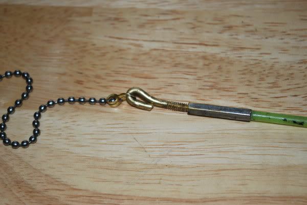

a few feet of wet noodle on the end and a flexible magnet always works for me.

Best way there is!

That's a great setup! I guess I was thinking more of using the pliers for simpler wire runs (than corners etc). Most of the time on those I can get the tape close enough to grab I just need something that can reach in and get it.
Is that chain made for tapes (i.e. higher quality)? The reason I ask is because I was wondering if the regular chain like that could handle being pulled on?

It's plain old steel beaded chain, like for a pull-chain fixture. I has to be steel for the magnet to grab. Stainless, aluminum or brass is out if you want to use a magnet.
I don't use it to pull in anything like NM. Maybe bell wire, but nothing larger. If I need to pull in something larger, I'll use this to pull back some mule tape and use that for the heavy pull.
I never had success with a ballchain on a rod as the rod is stiff and the chain is delicate, you try to bend the rod and you snap the chain.
Instead I put a 3-4 foot piece of quad on the tip and hook it with piano wire.
If I use a ball chain it's in a hollow wall, drill a 3/8 hole, insert a straw, feed chain, receive with wet noodle like TNT posted.
But let it be known that ball chain that comes with the wet noodle is complete garbage.
