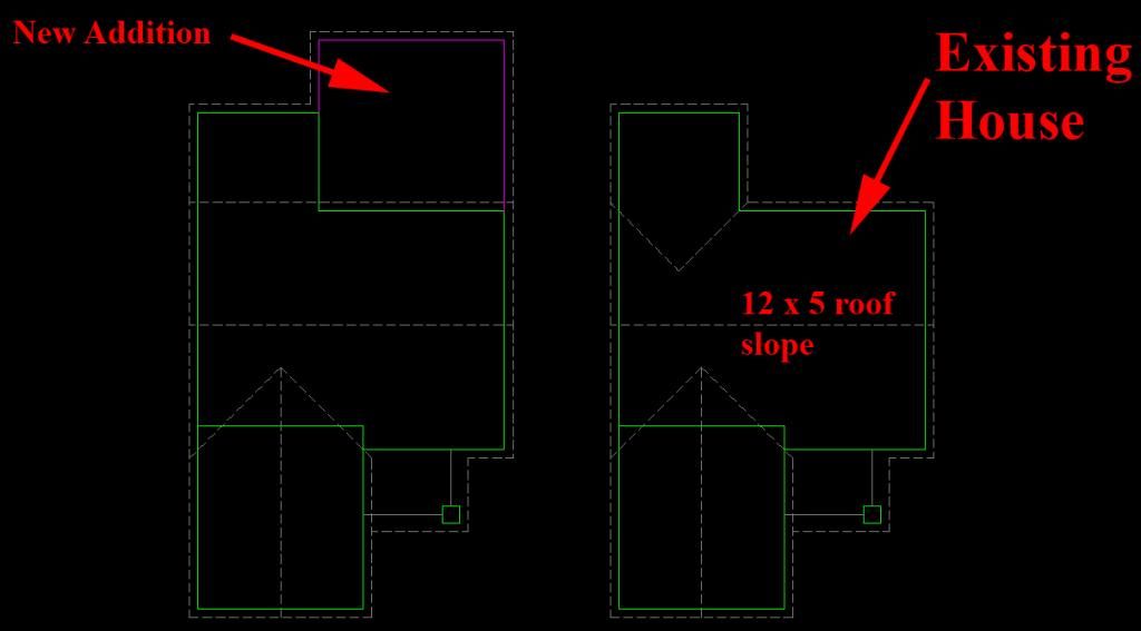

Hi Guys, I'm new here but I need help.
I'm planning to make an addition to my home. I'm drawing the floor plan, elevations, and roof plan on autocad but I'm stuck trying to figure out how to make the roof with this new edition. It seems like no matter what I come up with, it's not going to fit with the existing roof.

Could do this. Andy.
That's what I would do
Thanks for the suggestion scipio! Ill give that a shot. Never seen a roof with that odd middle piece though
If that "odd middle piece" has a less than 3 in 12 pitch, use a flat roofing system on it, not shingles. Good luck!:thumbsup:
Blind valley - common in additions. The more slope, the better.
The only other way I see, would be to extend the addition roof plane, & also the existing big roof plane so that there would be two big planes with a common ridge. That ridge would be higher than any of the existing roof. From the front view, you would have a small hip (kinda like a Dutch hip) sticking above the main ridge. It would be way more expensive, but would be simple shingle system.
Scipio's method should work fine, but as mentioned, I'd raise the slope, do a membrane, & then shingle main last. The hard part would be getting the membrane up under the existing roof. If your redoing the adjacent shingles, it's not a problem.

Andy's cricket... Getting I/W up under the existing was the most difficult part...
Whats the pitch on that? Clean looking work.:thumbsup:
The gables were 4.5 and the cricket about 2.5...
That's about the limit for shingles, even with I+W. Unless you're in a zero snow area.:thumbsup:

The cricket shown would be a tough decision for me also. I'd at least run it up to the ridge of the lower gable. Try to get as much slope as possible.
You could raise the wall height at the addition which would pick up the roof line, marry the ridge heights or lift the new ridge above the existing and have a gable end that would be visible from the front. I did something similar. I dont recommend using any shingle on the cricket area. Suggest an APP or fluid applied system below 3/12
