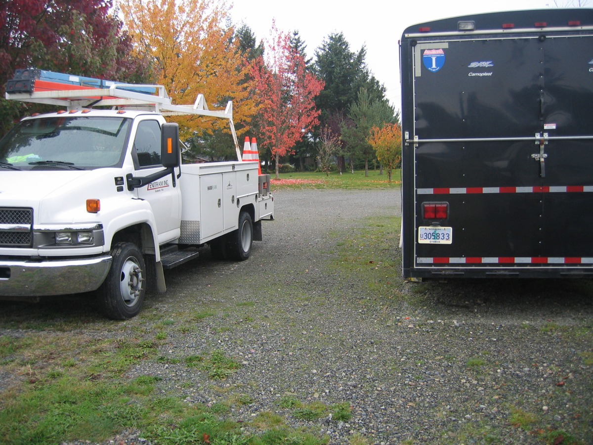

My 2005 Kodiak 4500 with Duramax seems to get the same mileage no matter what, about 12.5 mpg. But by itself and its normal load with 110 gallon transfer tank, and boxes full of tools, etc. it weighs about 14,000 lbs or so.
