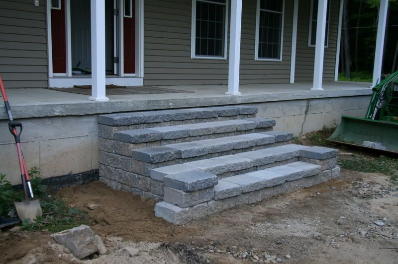

Lets just start off by saying, I am not a landscaper, nor do I want to be. You guys have a talent that no electrician can match, however, I wanted to try and conquer something myself. Critique as necessary.
Before:
First step of this adventure is to relocate the existing precast stair to the side of the porch. I wanted to get rid of them, as I had the mindset that they were only purchased to get our CO. The wife (boss) on the other hand said we spent $700 bucks on em, and we need to find a place for them.
Ultimately, they will have a paver landing, but this works for now.
Next step was to build new stairs. I dug out 18" of material, and replaced it with 1 1/4" processed.
Next was the front walls. Again, dug out, added processed, installed wall. Kinda boring, I know.

How am I doing so far?

The steps look a lot better and are a better fit in regards to concistancy of the steps. The top is a little shallow, but the steps themselves look good to me. The precast looked a little dangerous before you moved them with the high first step and loose gravel. Not my field either, but I am not sure the top step would be code compliant. Still alot better than the precast that steps were there.
All in all, I like what you are doing.

Looks pretty good man. As far as walls and stairs are concerned, the most important thing is to have a solid base and level first course.

Whats in the steps I see in one of the pictures you are doing the first coarse how did you build it up from there?

It looks nice but I wouldn't have the planter encroach into the stairs like it does on the one photo. If someone is walking down the stairs in that area they're going to have a strange step or actually no step where the top of the planter is running on top of the tread.
You can't be too careful with stairs, that's where 90% of accidents around the house occur.
