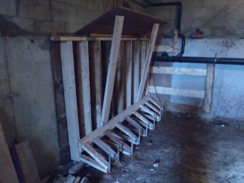

Hey guys. I have a client that wants their basement floor lowered a good 12-18 inches. This is something I don't have alot of exp with. (no worries I am getting quotes as well)
So what's the best way to do this. ?? I know there are a few methods.
The attached picture is what I am planing on doing. I figure we will dig down to the existing footings. Then start working 4' sections lowering and adding the footing extension.
Any tips or advice from you guys is always appreciated

Constructing the wall in a manner similar to the picture is guaranteed to leak for sure.

I think every homeowner with a basement under 8' wants "just a few more inches". The reason you won't find much info on the web on how it's done is because it's rarely done due to the cost and it's highly job specific.
The picture has a ton of issues. The joint between the existing footing and wall will constantly leak, unless it's in an arid climate. The existing concrete floor is just part of the system that's required to keep the base of the wall from rotating inward. W/O the floor there, you'll need some serious dowel work between the footing & wall. I wouldn't even bother trying to conjur up a guess as to cost to complete the job w/o first getting an onsite inspection & drawn plan from a structural engineer.

Jomama, it's actually quite common to underpin older homes in this neck of the woods. You are correct that there will be some water migration between the existing footing and the new bench footing. All of the underpinning I have done, we had to add dimple drain floor to ceiling along with a interior weeper.
Is it an acceptable method....for sure. Is it cost effective? That's for the clients to decide.
#8 ·
In Toronto you have to limit the underpinning to 3' lengths, separate by 6' undisturbed. If the foundation wall is crumbling, or the soil is sandy, you may have to limit to 18" section. We always put a layer of Delta MS or something like it from the interior weepers up to grade to control any water that may come in at the old footing level. You need a permit, and maybe a structural design as well. Since this is an expensive job, you should also push the client to put in radiant heating, which can be connected to the water heater. That depends on how large the floor is. There is a specific way to do the plumbing so that you don't get stale water in the pipes over the summer, and all of the parts have to be for potable water, including an all bronze circulating pump. Count on $150 per running foot of underpinning only, and then you have the excavation of the floor, the interior waterproofing and the new floor. You can also do some bench footing which costs about $100 per foot. We have done the benches in conjunction with underpinning. If you have a 1' bench, you can build shelving above the bench, or something like that. You will probably need a sump pump and pit, and also a sewage ejector pump. You should count on $1,200 each, installed and connected.
