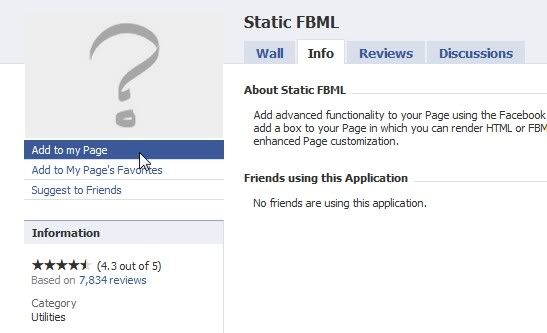

1. Install the Static FBML Application on Facebook
http://www.facebook.com/apps/application.php?id=4949752878
On the left hand side under the image, you will see this text, "Add to my Page." Click on it and a popup will appear, find your Fan page and click, "Add to Page." Click Close.

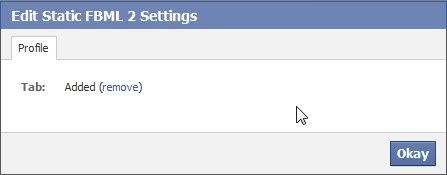

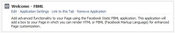

3. Scroll down and look for the FBML Application. Click the "Application Settings" and make sure the tab is added. Click Okay.

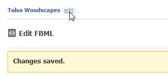

4. Now while still looking at FBML Application, click the "Edit" text under the FBML title. You will be redirected to a new window. Here is where we will implement our code but let's first give the new tab button a title. In my case, we went with, "Welcome." So in the "Box Title", input what you want your tab title to be called and click, "Save Changes." From here you will see a new box at the top saying, "Changes saved." We are done in here for now and need to go back to your main page edit section, so look above the "Edit FBML" title,
for your page name and the text "edit", click the "edit" link to head back to your page editing section.

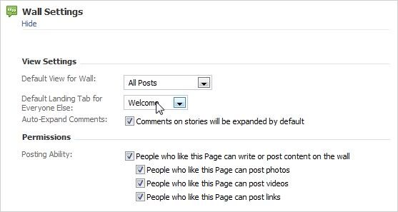

5. Now we need to go change a setting so that non fans once they click on your fan page, land on the new FBML tab you added. While you are still in the edit section of your page scroll to the top and find the, "Wall Settings." Click the "Edit" text, right under the title and it will expand. Here you have some decisions they are all up to you, we just need to change one setting. Look for the, "Default Landing Tab for Everyone Else" text. Click the drop down menu and find the name of the tab you added. So from now on, "Non-Fans" will land on the new tab you added. "Fans" will land on the default wall as usual.
