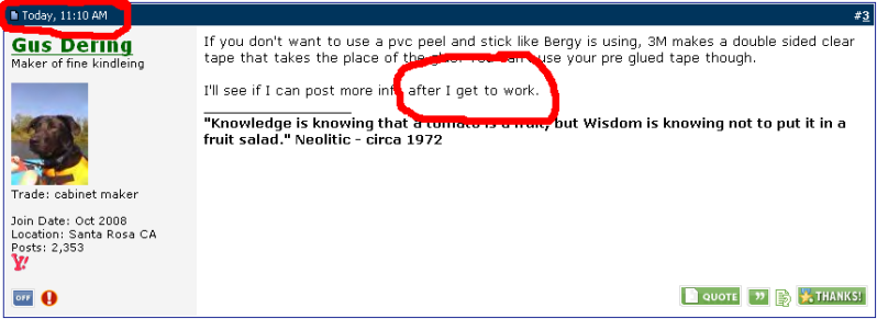

If you don't want to use a pvc peel and stick like Bergy is using, 3M makes a double sided clear tape that takes the place of the glue. You can't use your pre glued tape though.
I'll see if I can post more info after I get to work.

Gus, any photos of that 3M tape?
But we still haven't heard Bergstrom's excuse...:no:
sorry, I didn't get that done today.
let me see if i can find something from here at the house. I be back
seems as though it's not by 3m. It's a Fastcap thing.
It does work very well
