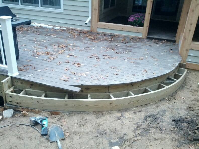

How do you frame your curved decks?
There's the kerf option, which creates a better curved, but some would argue invites rotting.
Others will trim the joists and just block at the ends of the joist, and let the fascia board smooth out the curve.
Thoughts on which way is better and why?
