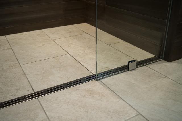

I had a meeting today with a homeowner looking to do a full master bath remodel.
She has in mind a curbless tile walk-in shower. We've tiled many many showers, including a couple of curbless now, but this is the first time I've faced this particular situation.
According to the blueprints she still has from the original construction (this part of the house was an addition), this bathroom is built directly on a slab.
Would I be correct if I told her that the only way to do curbless here would be to jackhammer out the shower area in order to be able to have a slope down from the rest of the bathroom floor? I mean, short of raising the rest of the bathroom subfloor up, this is the only way to get the slope, right? This is what I intuitively feel is the solution, but I want to make sure I'm not missing something stupidly-obvious before I send this quote over.

You could pour 3/4" of leveler in the rest of the house.. :lol:
Jack or grind out the shower as needed..
Not THAT far off from what my regular tile helper suggested, actually. He suggested raising up the rest of the bathroom floor, but then we'd have a pretty good threshold at the entrance to the bathroom.

Linear drain across the front, and pitch up the back ?
I'm fairly certain that we're going to find the drain assembly set in concrete once we bust up this shower. Adding a linear drain is a nice idea, but we'd still have to bust up concrete to get it in there flush with the rest of the bathroom surface.
Yes the drain will be in concrete and the sanitary will be >"Somewhere"<
under the concrete. The mystery is half the fun :censored:
Obviously there is a reason y'all are avoiding concrete demo. The linear drain concept here is the ideal solution. Gonna cost more than floating or raising the floor 3/4"+ ... but there has to be some transition somewhere without a flush solution.

How big of a shower foot print? Shower door or clear entry? nce you start breaking concrete at the drain the rest shouldn't be too bad. The gravel can be removed under the next edge creating a hollow spot that will break easy.
Membrane the shower floor and the rest of the room.

Curbless is what every aging in place house should have. Figure about 10 to 14 hours of pain for a good carpenter to cut, remove, cleanup and reinstall concrete. Almost every bath I do is cureless. Wood framed subfloors can get in to installing piers and footings because of joist span problems.
247 Posts
I've done curbless on framed rooms but not on slabs. If you have to bust up the concrete anyway to move or add a drain you may as well busy up a little more and slope it that way. Unless the shower runs the length or width of the room building up the back wall for a linear drain is going to leave you with a ramp shaped curb at the end...unless you do two linear drains but that's just getting ridiculous.

I've used my demo saw(beater wormdrive) with a masonry blade. No fumes. I score it with a shallow cut then full depth. You don't get all the way through but it will snap with a clean line. Old trick is a 2 liter bottle with a hole on the outside bottom edge. Fill with water and crack the cap to adjust flow.

it's much easier to do in framed rooms than on a slab, but i'v done it.... just takes longer
jack it out
This depends on which way the joists go. Id much rather spend 20 minutes with our jack hammer than have to modify and reengineer the floor joists..
