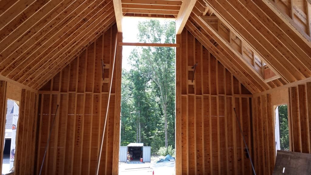

Ive never seen a whole house framed with that laminated timber. Not the whole thing!
What do you think those beams weigh?

not sure, BUT, ones missing a jackstud
wrong photo left jack dtud missing.
[/QUOTE]
Toke me a few to look at this, BUT the one beam on the right is ON the post, the one on the left???? Did I, or am I missing something here? Seeing incorrect? Please inform me! Thanks, dave
Its sitting on a beefy post.
my 2nd post,
top left hand corner of picture.
looks like the beam isn't being supported.
Am I missing something, I blew the photo up to 250%
something looks wrong there.
Maybe it's the photo
I dunno, its sitting on the post below it?
must be the camera angle.
The post is notched to accept the beam, I'm guessing so that it lines up with the other studs. The reason it looks wrong is because you're looking at the back side of the other one and the cut is nice and tight
