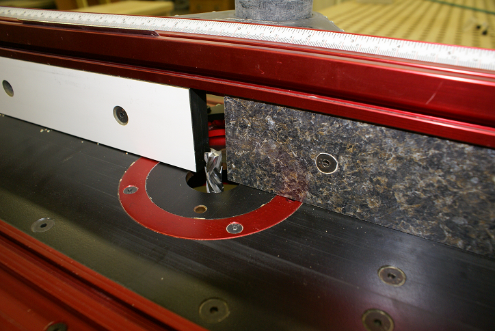

Here is a way that I came up with to alleviate melamine chipping when you are not using a CNC or a scoring blade. Most of the time you can hide chipping by turning the chips out to an unexposed area however on things like shelving and euro cabinets it can be difficult if not impossible to conceal them

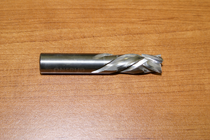

The key to the set up is a compression cutter. The bottom of the bit is an upshear while the top is set up as a down shear. This particular bit is a Onsrud 60-569 4 flute compression spiral
1 - 12 of 12 Posts

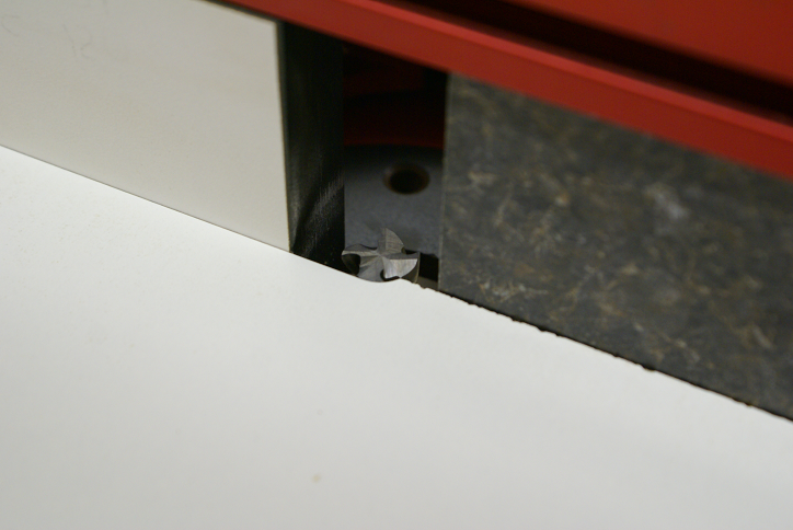

The infeed fence on my router table is replaced with an 1/8" thinner version. The same thing could be accomplished my shimming out the out feed fence
The parts are cut 1/8" oversize and then run through the cutter

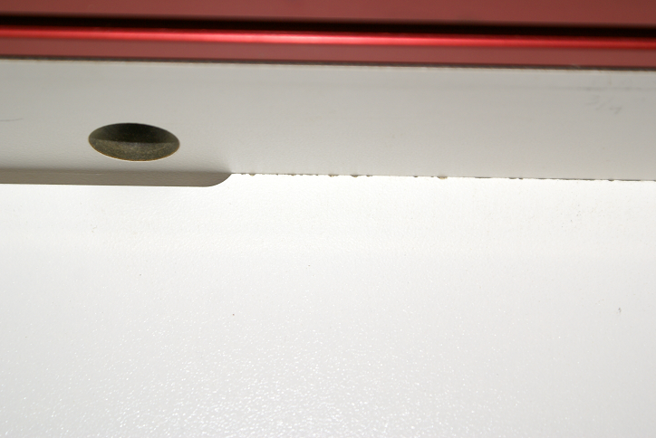

Here is what the cut looks like. It is just as good on the bottom side.

Alright, so where do you purchase those guys? Locally or is it online? Solid Carbide?
I need to stop coming here. I don't have enough money as it is.
edit: nvm, found this place. $137 among hundreds of other bits. Just great.
http://www.ballewsawandtool.com/catalog/Onsrud.pdf

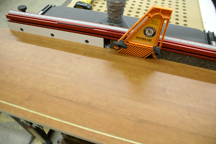

Here is what I was using this particular set up for, a melamine built in closet organizer
