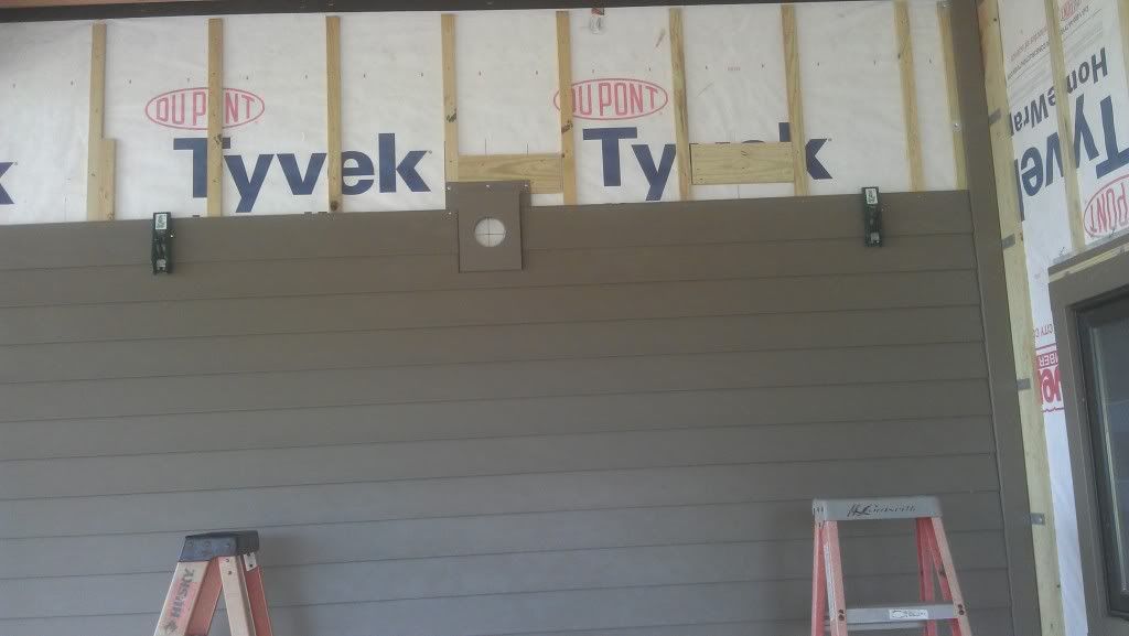

Here is a job I did. We installed 2" EPS and Tyvek over the entire building.
Once that was done we cut holes everywhere we needed a fastener and installed a 2" block to fasten our siding to. Was very labor intensive. Craziest thing i've done in the business. It was a LEED certified building.
This picture show's where we put a block every 12" so the stone veneer could be attached.
