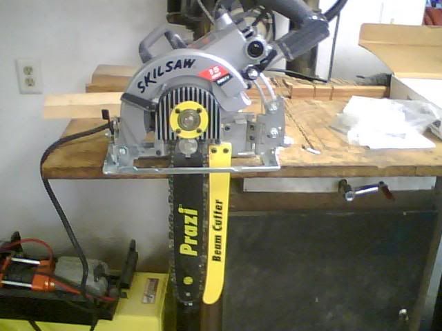

I gave up on using a circular saw for PT stringers, the boards are just too inconsistant to get a solid/dead on layout like we do with normal lumber...so, i said to self- "self, how would a person be able to reproduce all stringers to be the same?" and the answer was "cut them all at once dumbazz" So that's what i did, a freind of mine had a Prazil for sale, i bought a Skill Mag, i married the two and have been jutting 4-6 set stringers at a time ever since. Plus this tool has been called out on a host of other odd jobs now that we have it....nother tool that you find usage for since you got it.:thumbsup: But the blunt of it's work asked to do is post notching for beam insets since you clean notch 6x6's in 2 cuts, cut them off to length in one cut, as well as stringers..so 98% of the time it's used for building decks.
Very rarely do i ever cut single stringers anymore...too fricken time consuming and hard on my back, the prazi is'nt cutting each cut as fact as a skill saw, but your cutting 4-6" stringers at once you your way ahead of the game time wise....just be sure to keep the blades sharp, once you hit any metal...it's junk and needs to be sharpened or replaced.
I forgot I had a prazi saw.
I'll have to use it on my next set of stairs.
I bought it to gang cut floor joist, but didn't find it to be as good as I thought it might.
If I ever do a 2x10 floor it should be awesome.
