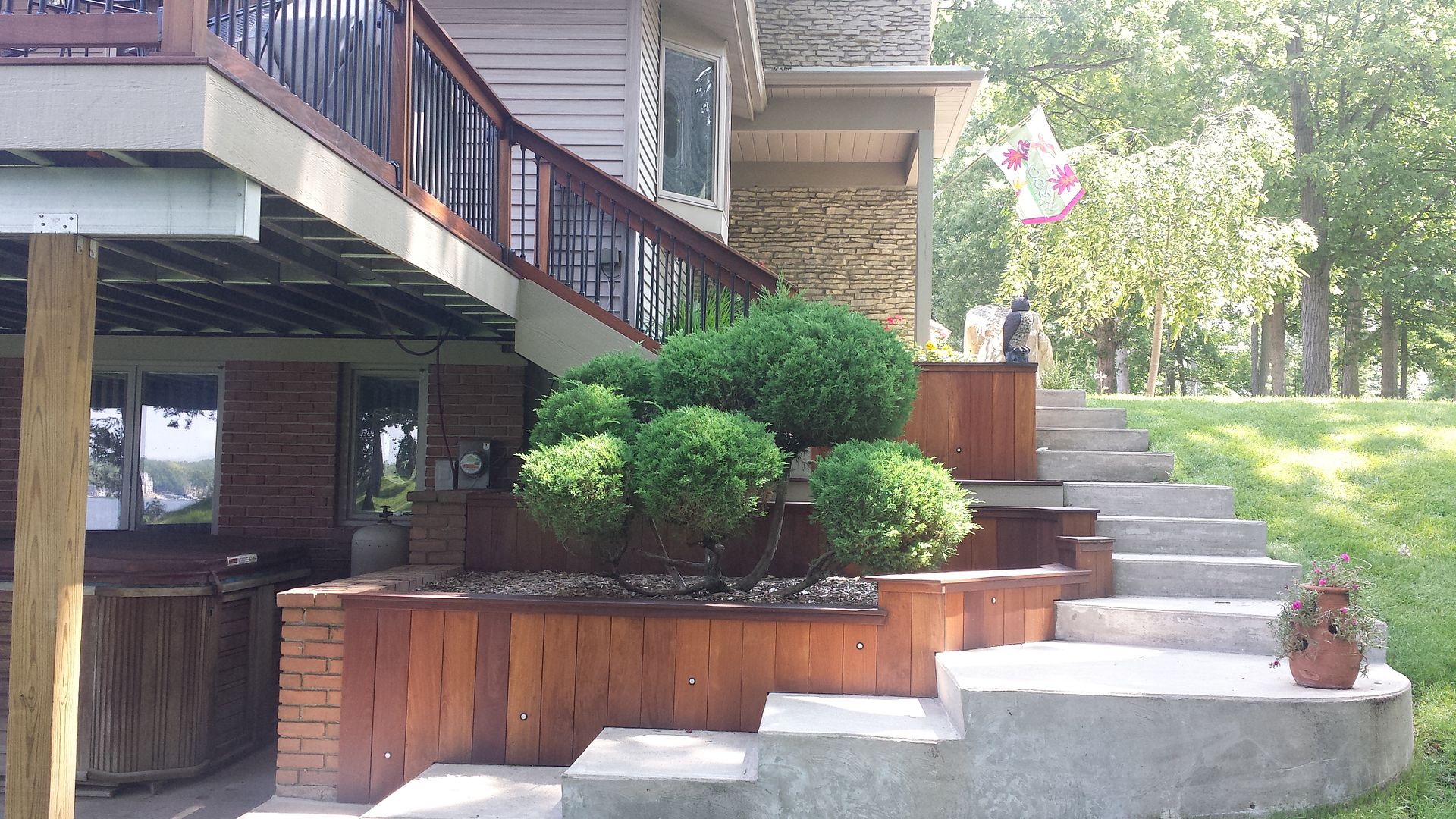

#20 ·
Here's an ipe deck re-finish job I did this week. Used the big sander on the floor & pressure washer on the stairs & railing post. I used a blend of twp 101 (cedar) & 116 (rustic) on the ipe then added some dark oak for the cedar pool deck.
