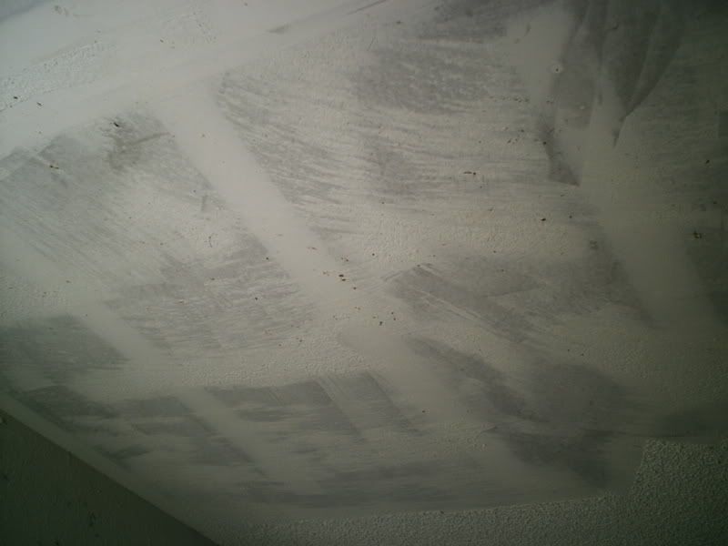

I am officially highjacking this thread. Here is a unit I painted and did some work on that a lady turned her head inside out with a shotgun in.
I walked out of it. I got the call and went to do it knowing what happened, and then seeing what the "cleaner" < official BIO cleaner (btw.. 13hrs was $3000.00 fyi) left. I turned around and got on the cell and told the manager NO WAY. Get that guy back NOW. I WILL NOT DO THIS. She told me to go get kilz
