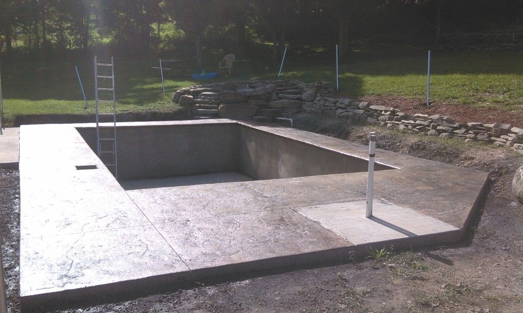

I have mentioned it a few times here already, but we are now ready for plaster in dads 100% DIY (meaning I have to help do everything) concrete pool.
The walls and floor are in, the deck an coping are poured and I am going to get a load of sand and half a pallet of portland in the morning.
I have done a ton of stucco with a regular portland-lime-sand mix. From what info I can find though pool plaster is mixed 1:2 portland:sand.
I have never worked with a rich portland mix with no lime, it sounds horrible to be honest, the thing is just a big rectangle, so at least there shouldn't be too much corner work, just the 4 verticals and the coves.
How are they typically finished, trowel finish only, or is it okay to break out the sponge?
Here is what I am working with (I didn't stack those rocks either, that is all the old man :whistling)

If you need a bonding agent, that's just white Portland cement and acrylic fortifier mixed in a plastic garbage can (thin mix), and rolled on with a roller cover that leaves some stippling.
The standard white pool job is white portland cement with "pool mix" (crushed marble) for aggregate. You can get a huge variety of colored aggregates as well.
Sponges are good for getting material spread in the corners, then go with the trowel to smooth it.

Pool plaster is not regular stucco. Regular stucco is not water proof.
Pool plaster is 1 part portland to 1-1/2 parts marble dust. A 30% solids bonding agent can be added at 25% of mix water. Do not stop once you start, and fill with water as soon as you finish.
