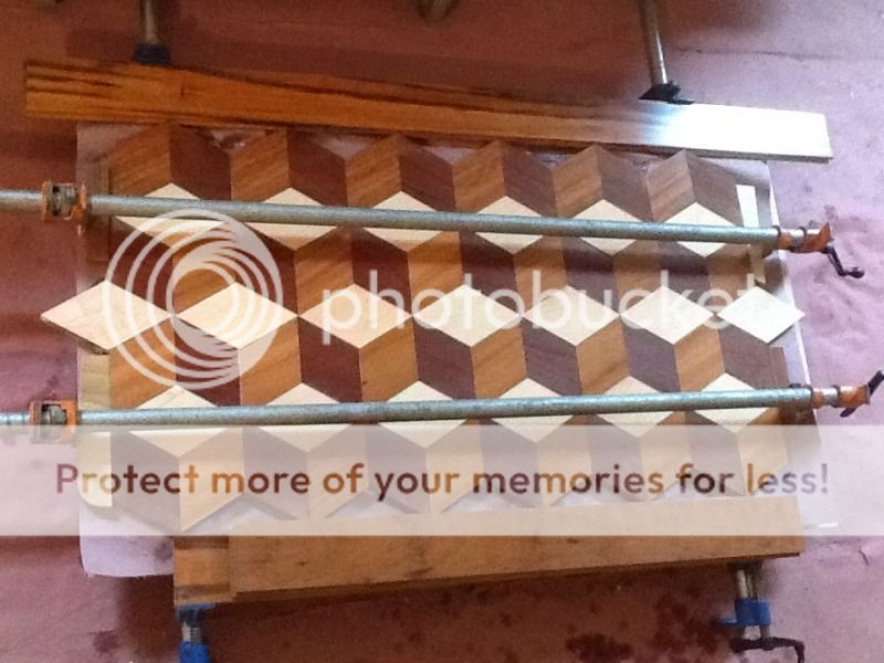

Something I have been working on the past few weeks,,,,,
The blond is maple, the tan tone is African Koa , and the dark tone is Merbau..... All 3/4" assembled with TB III and biscuits #20's
This is going somewhere and I'll have that up when I get to that point...
It is defined as "tumbling blocks"....

Are you putting those together as rows and biscuiting the rows together? Looks good and its the little intangibles that people don't think about when something like that has to "come together".
You made a tough job look easy. How does the Koa and merbau glue up with each other, a bit finicky?

I didn't have any issues with the glue up other than getting them together and clamped within the work time for the TB III . I'll have some finals of this when its all done,......

Good idea. Is the design you made just glued to the floor? The rest of the floor nailed?
Can't speak for this project, but when we put in inlays, we glue them with bostiks best & put in a few finish nails to hold them in place while the glue sets. Our inlays come with a template I use to route into the already laid hardwood.

It is not glued to the floor.......:no: the tumbling block assembly was biscuit joined & glued , then a groove milled into the entire perimeter after it was cut to size- a spline was inserted into the groove ,glued and then the inlay was toe nailed down to the floor.
I have pictures of this project and will have more,
