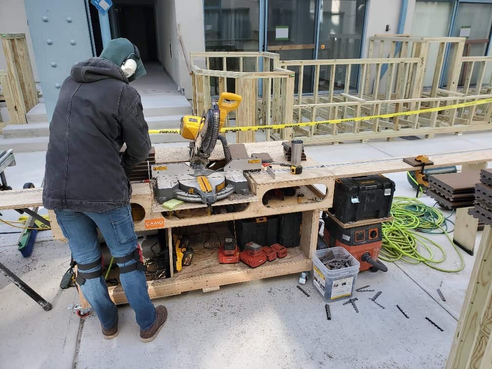

I picked this up for this job. We rarely use miters in field. And or even has the space. No room and just simply faster with cordless wormdrives.
This thing averages 2000 / cuts a week.
I run it on 2/ 9 amp and 2/ 6amp. Precision/ power dead on all around. The word from dealt is keep it on batteries all the time. They've been burning out when used on plug converter. They've also expended warranty indefinitely until they find the problem.
20 min modification with Bosch dust boot ($13) gets the DC to 90-95% with pt lumber and Composite I'm about 70%. Using fein t1 rigged with landscaping fabric over filter cage (plastic housing that surrounds fram looking filter) reduce cost and time. I don't think I could be happier.
A real worthy buy.

still running it on same job. over 16,000cuts since purchase (for this job) I have another 7000 ft of decking coming this week for the final stage of this job. It will put it around 25,000cuts in 2 1/2months. It has never touched a plug. Running only batteries. Other then keeping an eye the weather and taking dewalt batteries home when temps drop below Freezing this thing has hassle free / just as good as new. My wings / paulk staton has served me very well. On the other hand are warping and looking ragy from all the rain then freezing and more rain again. When I'm wrapped up on this project I'll rework the paulk bench with pvc top (few other things) fastcap best fence to be intergraded into paulk station. I'll also use them on dewalt stand. I only use miter when doing interior trim on our additions and thats the 7 1/4" dewalt cordless which is another excellent work horse.

That is about as nice a work station as I have seen. I use the DeWalt miter saw stand, because we are always doing log stuff, but I would build that design for my shop for sure.
It usually stays in shop. In this job I have space for day's. Once I'm done here I'm going to retro fit it out with pvc top and best fence wings integrated flush top. Rain really killed wings magnets strips for tape etc..

I was just getting ready to rebuild a table and fence system for the shop. Going to copy that if it's all good with you. Going to mod a bit for the kapex and longer wings though.
The problem I've heard with the battery miter saws is that they cant run a full sized blade. I cant stand those thin kerf blades. Cutting exotics on a bevel causes deflection.
